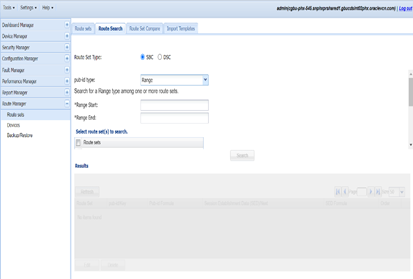

Search for Route
Sets
Expand the
Route
Manager slider, and click
Route
sets.
Select the Route Search tab
on the top. The Rouet Search page is dynamically loaded according to the pub-id
type.
If you set the pub-id type as E164 or
String, the page displays the pub-id field.
If you set the pub-id type as Range the page displays
Range StartRange End.
Figure 4-11 Route Search Dialog box
Select the checklist corresponding to the Route set (from which you want to
extract the routes).
Click
Search. The results
appear at the bottom of the screen. You can page through the results.
Click
Refresh to refresh
the display.
Select a table row
and either click
Edit to access the
Edit
Route dialog box to modify the route, or click
Delete to delete the
route from the route set.
