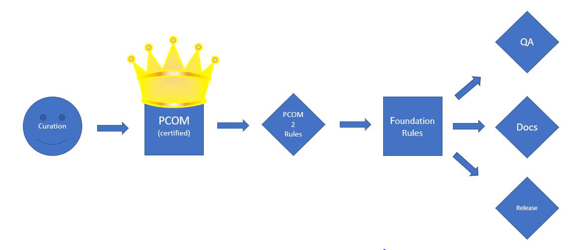

The following diagram shows the overall process for creating foundation rules with a pre-certified PCOM file.
