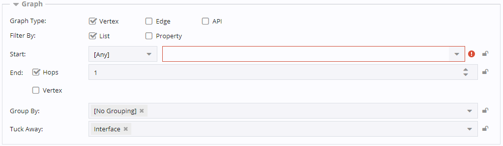

Graph Type:
Vertex: The graph is dependent on a particular vertex. The graph will focus on this vertex. Other options will determine how the graph is laid out, but this vertex is where everything begins.
Edge: The graph is dependent on edge properties. This is useful if you want to graph a particular path based on edge properties such as circuit, ticket, or customer.
API: The graph is dependent on a custom API instead of the default Assure1 graph API.
Filter By:
List: This option is currently only applicable when the Graph Type is set to "Vertex". It indicates the graph will either be rendered out to a certain number of hops, or to an end vertex.
Property: This option is applicable when the Graph Type is set to "Vertex" or "Edge". It indicates the graph should be dependent on the chosen property rather than a particular route.
Options for: Graph Type = Vertex, Filter By = List
Start:
The first dropdown list filters the second dropdown list. The default selection is "Any", but you should choose a vertex type if possible. This will greatly enhance the graph load time. Typical values are "Device" or "Service", but all vertex types are in the list.
The second dropdown list is the actual vertices. This selection will determine where the topology graph begins.
End:
The "Hops" or "Vertex" checkbox determines if the graph will go out X hops from the start vertex in every direction or just go directly to the chosen end vertex by the most direct route possible.
If "Hops" is checked, then a number of hops must be set. Every edge is considered a "hop". For example, DeviceA -> Interface1DeviceA -> Interface1DeviceB -> DeviceB would be 3 hops.
If "Vertex" is checked, an end vertex must be selected in the same fashion as the start vertex. You can restrict the list by vertex type, then choose the actual vertex. An empty graph will be presented if no path exists between the chosen start and end vertices.
Group By:
This determines how vertices are nested. If you choose a group by vertex type, then everything that is connected to that type will be nested inside of it. This option is almost always left to the default value of "No Grouping". An example would be if you only wanted to see your networks at the top level, you could set Group By to "Network". The graph would only show network vertices. Everything else would be nested inside of the network vertices. This is not a commonly desired scenario. Here is an example with no Group By set:

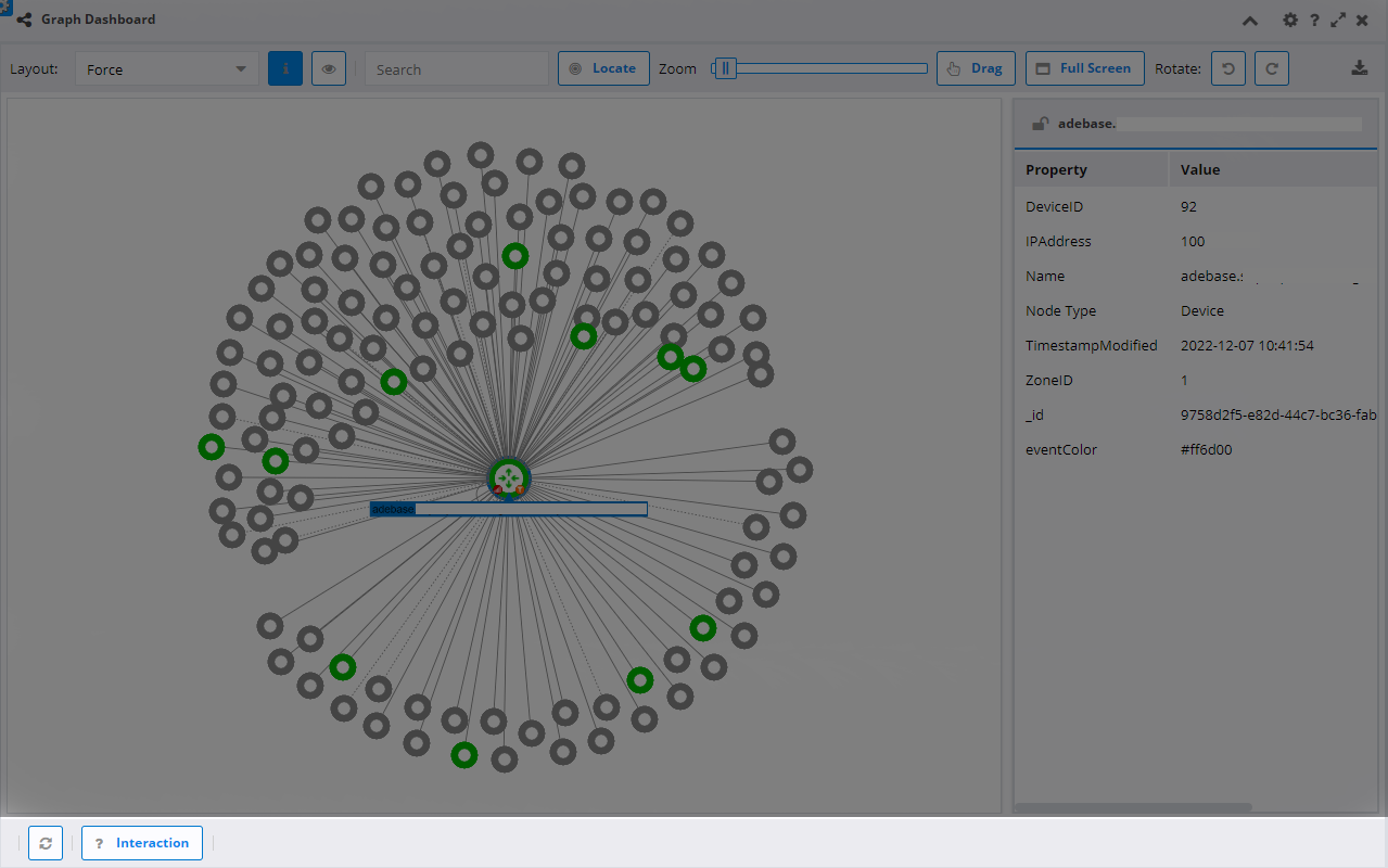

Description of illustration topology-graph-dashboard-panel-form-group-by-no-grouping.png

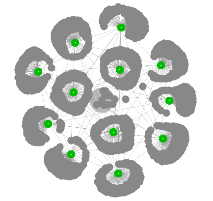

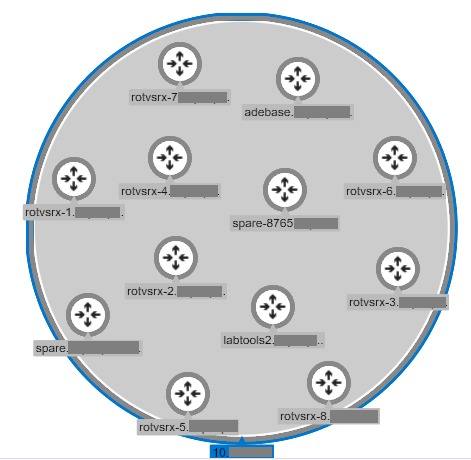

If we rerun the same selection, but set Group By to Network, all of the associated devices will be nested inside of the network vertex.

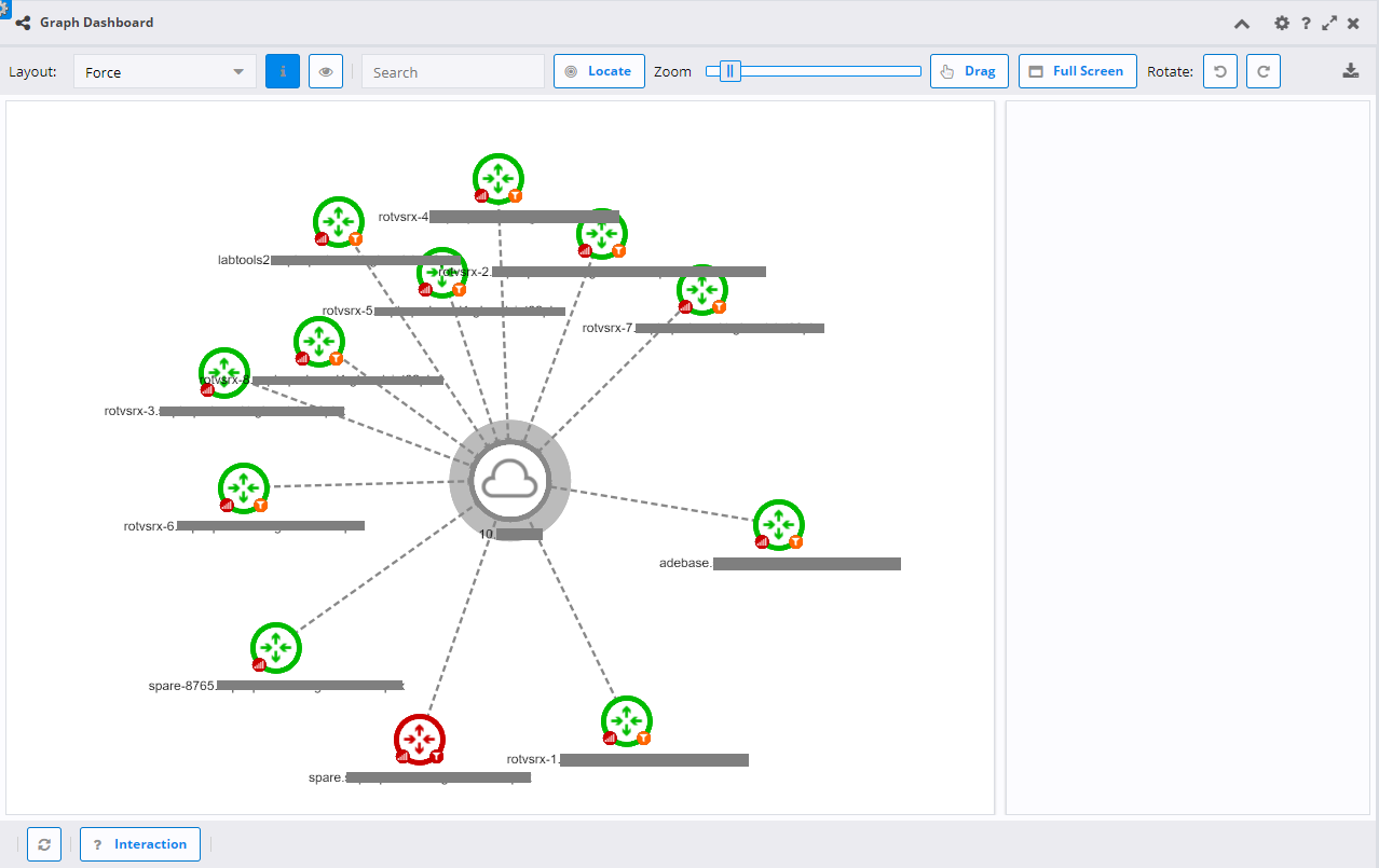

Description of illustration topology-graph-dashboard-panel-form-group-by-network-collapsed.png
Note the "12" in the top right corner that indicates there are now 12 vertices inside of this one. When the network vertex is double-clicked, we can see the 12 devices again.

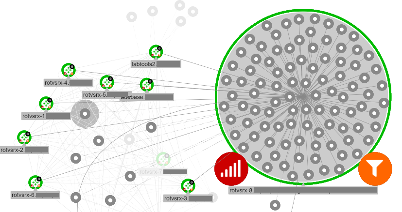

Description of illustration topology-graph-dashboard-panel-form-group-by-network-expanded.png
Tuck Away:
This also determines how vertices are nested. The chosen vertex type will be nested inside of the parent vertex if one can be determined. A common use is tucking interfaces inside of the parent device. Here is an example:

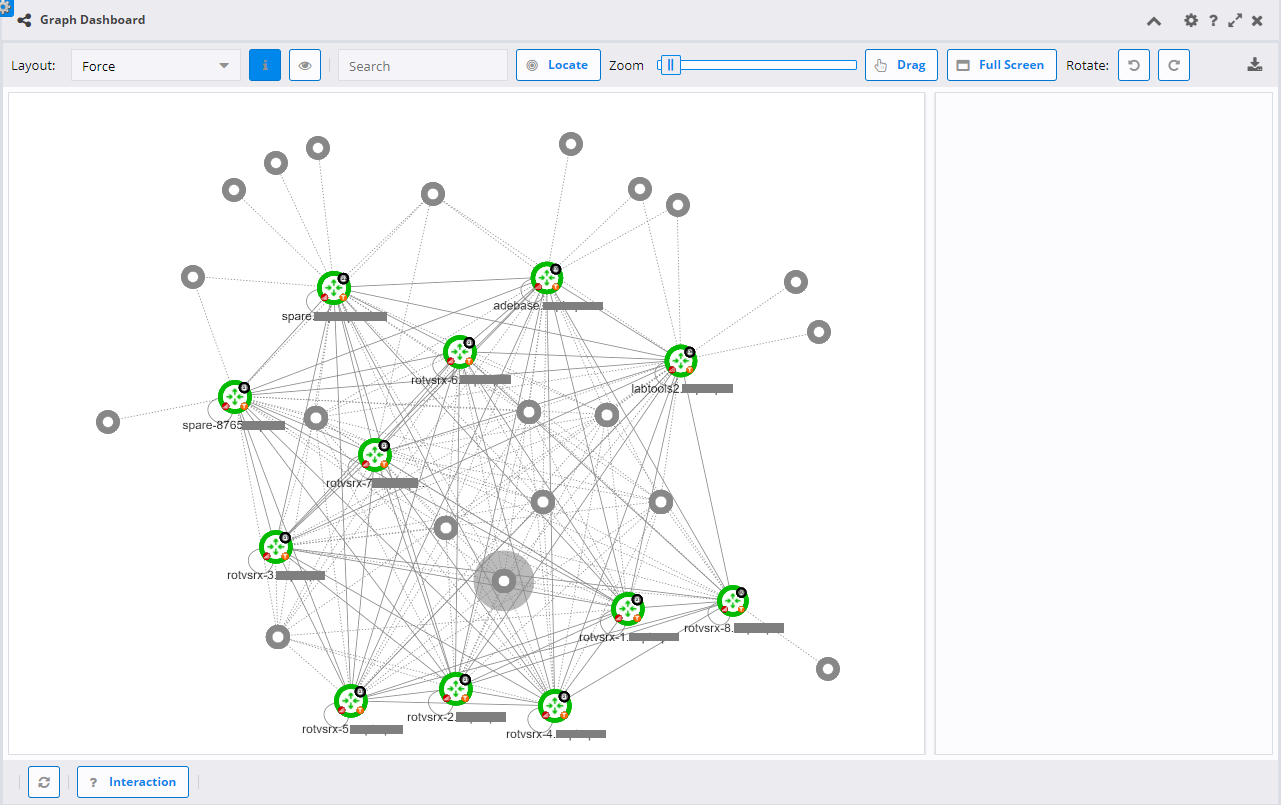

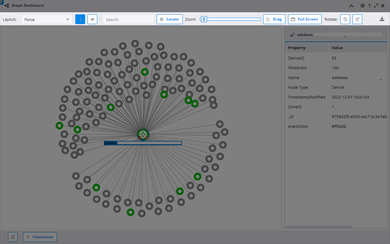

Description of illustration topology-graph-dashboard-panel-form-tuck-away-no-tucking.png
This graph is so busy with interfaces that it becomes almost impossible to see any details. When the interfaces are tucked away, it becomes much easier to discern items of interest.
Description of illustration topology-graph-dashboard-panel-form-tuck-away-interfaces-collapsed.png
This is the same graph, but now the interfaces are all tucked away inside of the devices. We can still see the interfaces by double-clicking a device.
Description of illustration topology-graph-dashboard-panel-form-tuck-away-interfaces-expanded.png
The zoom and/or search features can be used find specific information and see labels.

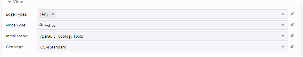

View Settings
Description of illustration topology-graph-dashboard-panel-form-view-settings.png
Edge Types:
Some Graph Types allow the limitation of edge types in the graph. Adding one or more Edge Types will limit the graph to just those edge types. Setting Edge Types to "Any" will include all edge types.

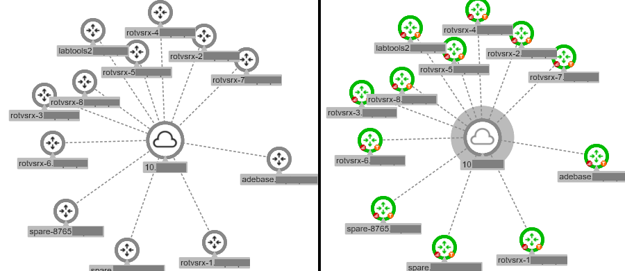

Node Type:
The node type is either "Basic" which means it will just load the graph and no state information (event and metric badges as well as node availability), or "Active" which will load the details.
Description of illustration topology-graph-dashboard-panel-form-node-type.png
Initial Menu:
This allows the root context menu for the graph to be changed.
Geo Map:
This allows you to switch from the default map tile server to a custom tile server
Tile Server:
If Geo Map is set to "Custom", then this field allows you to give the URL for a custom tile server.

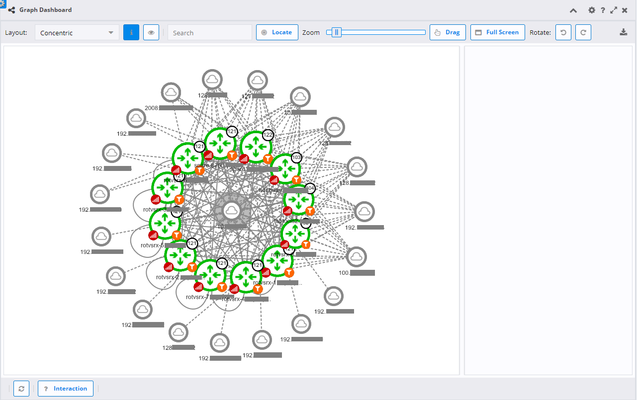

Concentric - This layout takes a base node as parameter and organizes the graph so the nodes close to the selected node are arranged in a circle around it. Each hop forms another circle.
Description of illustration topology-graph-dashboard-panel-form-layout-concentric.png

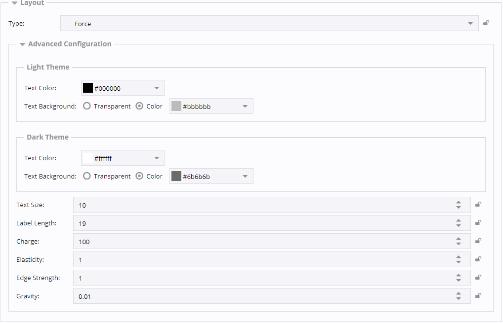

Force - This layout uses defined forces to attract or repel vertices from each other. The advanced configuration options will greatly affect the outcome, but the general layout will be spread out with the Gravity, Edge Strength, and Charge pushing the nodes apart.
Description of illustration topology-graph-dashboard-panel-form-layout-force.png
Advanced Configuration
Charge - Distance factor between nodes. A greater value increases the distance.
Elasticity - Node collision elasticity. Smaller values may result in incomplete node overlap removal. Passing 0 will skip that algorithm pass altogether.
Edge Strength - Attraction strength. Higher values make edges' attractive force stronger.
Gravity - Force that attracts nodes to the center of the graph. Center is either the mass center of the graph or the value defined by cx and cy. Greater value makes the layout more compact.

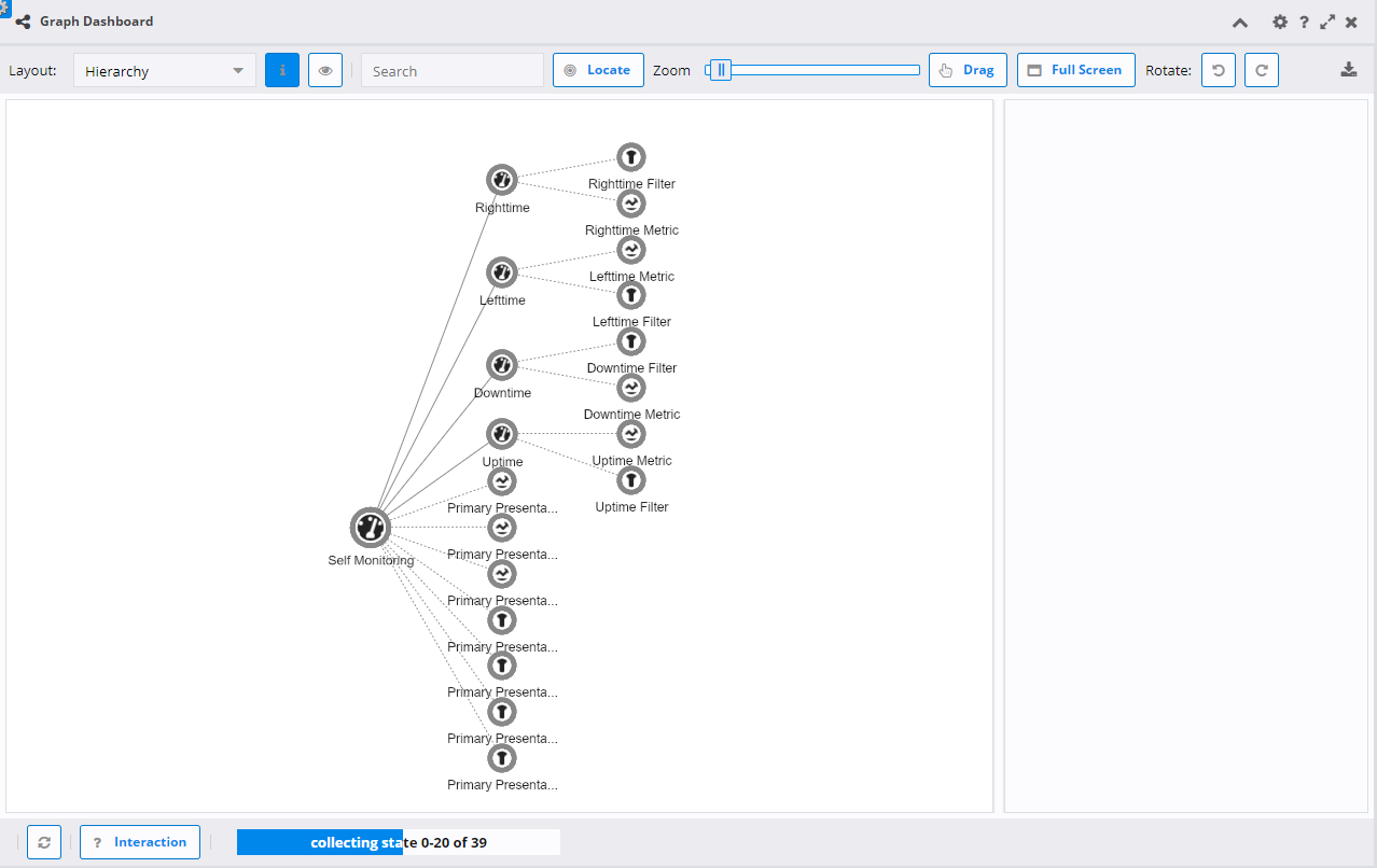

Hierarchy - This layout positions nodes starting from a root node downwards generating a visual hierarchy based on connectivity.
Description of illustration topology-graph-dashboard-panel-form-layout-hierarchy.png
Direction - The direction the graph will flow (top to bottom, left to right, etc).
Level Distance - Desired distance between the layers of layout.
Node Distance - Desired distance between the nodes on one layer.

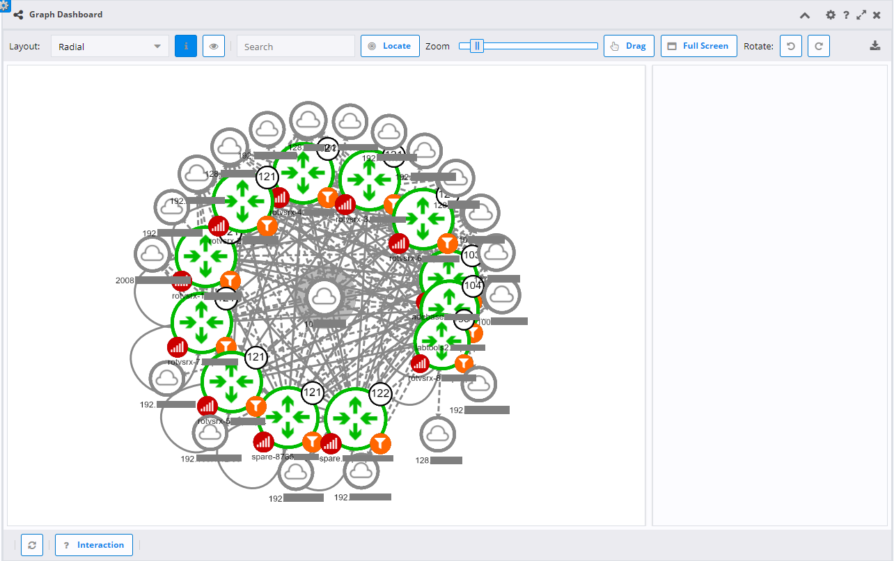

Radial - This layout positions nodes around the selected one based on their graph-theoretical distance (the shortest path in the graph, connecting them). If there are sub-graphs or nodes not reachable from the central node, they will be pushed outwards, but still placed around the layout in a readable way.
Description of illustration topology-graph-dashboard-panel-form-layout-radial.png
- Repulsion - Increase or decrease the repulsion force between the nodes on the same levels. Values smaller than 1 will result in more compact placement along the layers.

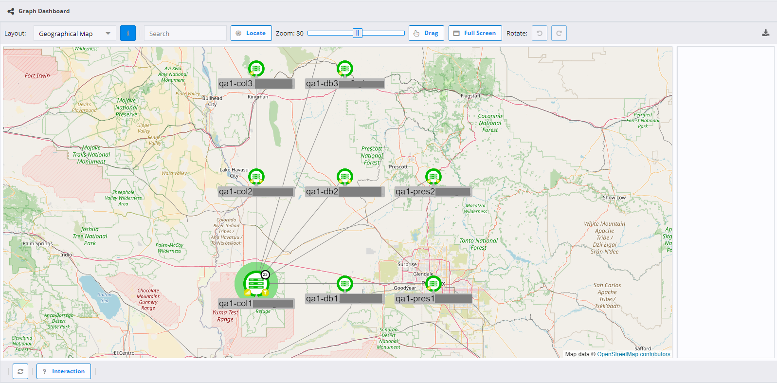

Geographic Map - This layout uses a geographic map as the background and places the nodes at their specified latitude and longitude.
Description of illustration topology-graph-dashboard-panel-form-layout-geographic-map.png

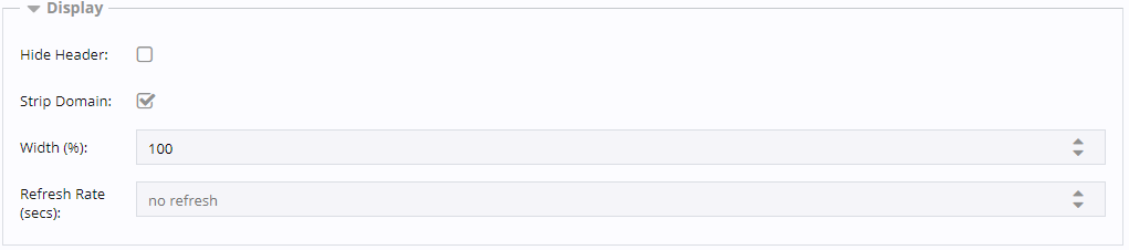

Display Settings
Description of illustration topology-graph-dashboard-panel-form-display-settings.png
Hide Header:
This checkbox hides or displays the panel header when the panel is rendered. This is most useful for reports or if screen real estate is limited.
Strip Domain:
This checkbox hides or shows the domain name on vertices. This is useful if there is only a single domain name so it is repetitive information, or the domain names are extremely long and make the node labels difficult to read.
Width:
This indicates what percentage of the available screen width should be used for the panel.
Height:
"Auto" will adjust the panel height as the content changes. This setting is generally not suggested for the topology because the graph will adjust the zoom to the height of the panel. "Auto" will default to 400px. If you want a different height, uncheck "Auto" and set the desired height in pixels in the number field below the checkbox.
Refresh Rate:
This allows the refresh rate to be set in seconds. This refresh rate determines how often the vertex details are updated. If no refresh rate is specified, the state will only load a single time when the graph is loaded.

Vertex
The large, central icon represents the vertex type, such as network, interface, or a device type. The color indicates the availability: red = 0%, green = 100%, and yellow is anything between.
The bottom left icon represents the metric threshold status. The color indicates the highest severity threshold breached.
The bottom right icon represents the event status. The color indicates the highest event severity.
The top right icon represents the number of vertices tucked away inside the vertex. If a number is present, double-click the vertex to expand it so the nested vertices are visible.
Edge
- The edge will typically be gray unless customized. The edge will have an arrow at one end to indicate the source/target relationship. Select an edge to highlight the edge and the nodes at either end. Selecting the edge also fills the information pane with the edge details.

Example Process
Description of illustration topology-graph-dashboard-panel-example-process-form.png
Select a Start Vertex.
Set the number of Hops.
Set the Tuck Away to Interface.
Set the Text Background to Transparent for both themes.
Set the Label Length to an appropriate value.
Uncheck Auto Height.
Set the Height value in pixels.
Click the "View" button.
The result will look like this:
Description of illustration topology-graph-dashboard-panel-example-process-view.png
