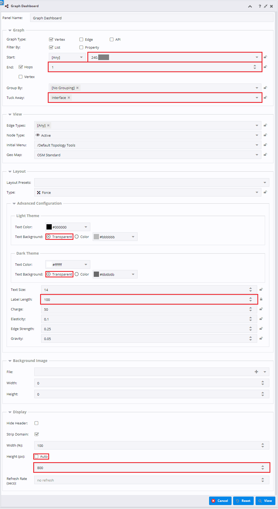

Panel Name
- Title for the topology view panel.

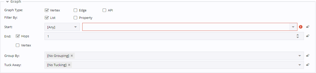

Graph Settings
Description of illustration topology-graph-dashboard-panel-form-graph-settings.png
Graph Type
Vertex: The graph is dependent on a particular vertex. The graph will focus on this vertex. Other options will determine how the graph is laid out, but this vertex is where everything begins.
Edge: The graph is dependent on edge properties. This is useful if you want to graph a particular path based on edge properties such as circuit, ticket, or customer.
API: The graph is dependent on a custom API instead of the default Assure1 graph API.
Filter By
List: This option is currently only applicable when the Graph Type is set to Vertex. It indicates the graph will either be rendered out to a certain number of hops, or to an end vertex.
Property: This option is applicable when the Graph Type is set to Vertex or Edge. It indicates the graph should be dependent on the chosen property rather than a particular route.
Options for: Graph Type = Vertex, Filter By = List
Start
The first dropdown list filters the second dropdown list. The default selection is Any, but you should choose a vertex type if possible. This will greatly enhance the graph load time. Typical values are Device or Service, but all vertex types are in the list.
The second dropdown list is the actual vertices. This selection will determine where the topology graph begins.
Enter text to filter the list. The filter is case-sensitive.
End
The Hops or Vertex checkbox determines if the graph will go out X hops from the start vertex in every direction or just go directly to the chosen end vertex by the most direct route possible.
If Hops is checked, then a number of hops must be set. Every edge is considered a hop. For example, DeviceA -> Interface1DeviceA -> Interface1DeviceB -> DeviceB would be 3 hops.
If Vertex is checked, an end vertex must be selected in the same fashion as the start vertex. You can restrict the list by vertex type, then choose the actual vertex. An empty graph will be presented if no path exists between the chosen start and end vertices.

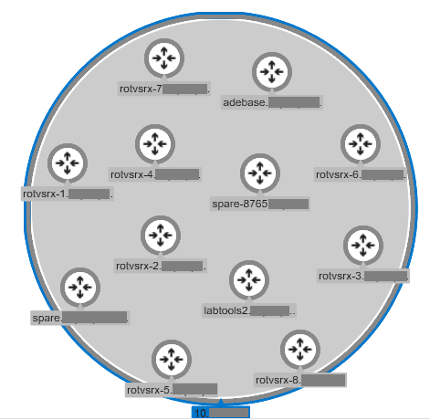

Group By
This determines how vertices are nested. If you choose a group by vertex type, then everything that is connected to that type will be nested inside of it. This option is almost always left to the default value of No Grouping. An example would be if you only wanted to see your networks at the top level, you could set Group By to Network. The graph would only show network vertices. Everything else would be nested inside of the network vertices. This is not a commonly desired scenario. Here is an example with no Group By set:
Description of illustration topology-graph-dashboard-panel-form-group-by-no-grouping.png

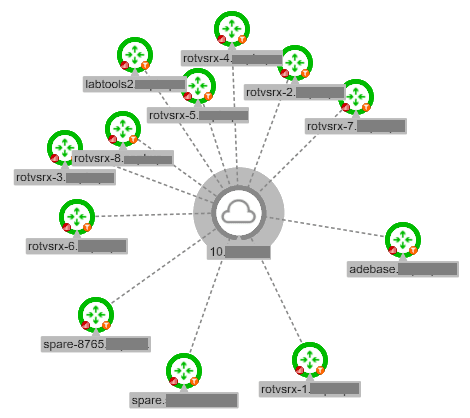

If we rerun the same selection, but set Group By to Network, all of the associated devices will be nested inside of the network vertex.
Description of illustration topology-graph-dashboard-panel-form-group-by-network-collapsed.png
Note the 12 in the top right corner that indicates there are now 12 vertices inside of this one. When the network vertex is double-clicked, we can see the 12 devices again.
Description of illustration topology-graph-dashboard-panel-form-group-by-network-expanded.png

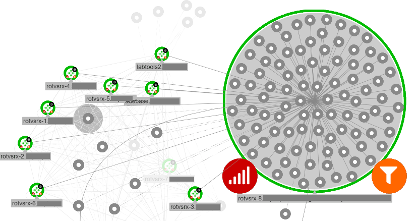

Tuck Away
This also determines how vertices are nested. The chosen vertex type will be nested inside of the parent vertex if one can be determined. A common use is tucking interfaces inside of the parent device. Here is an example:
Description of illustration topology-graph-dashboard-panel-form-tuck-away-no-tucking.png

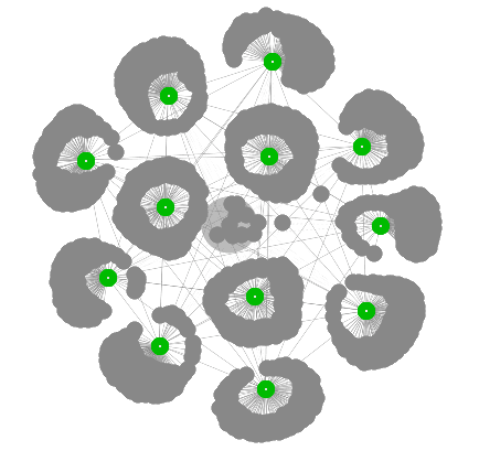

This graph is so busy with interfaces that it becomes almost impossible to see any details. When the interfaces are tucked away, it becomes much easier to discern items of interest.
Description of illustration topology-graph-dashboard-panel-form-tuck-away-interfaces-collapsed.png
This is the same graph, but now the interfaces are all tucked away inside of the devices. We can still see the interfaces by double-clicking a device.
Description of illustration topology-graph-dashboard-panel-form-tuck-away-interfaces-expanded.png

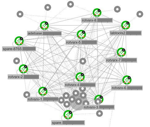

The zoom and/or search features can be used find specific information and see labels.

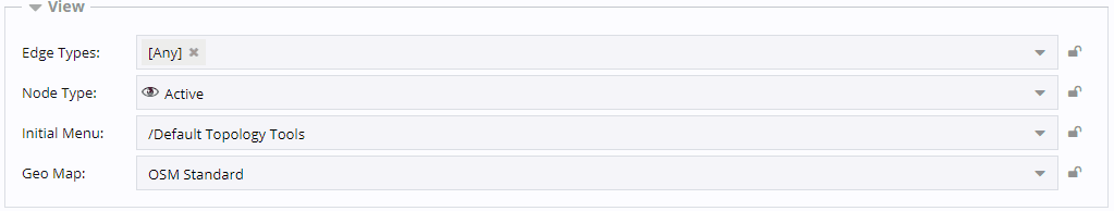

Node Type
The node type is either Basic which means it will just load the graph and no state information (event and metric badges as well as node availability), or Active which will load the details.
Description of illustration topology-graph-dashboard-panel-form-node-type.png
Initial Menu
This allows the root context menu for the graph to be changed.
Geo Map
This allows you to switch from the default map tile server to a custom tile server

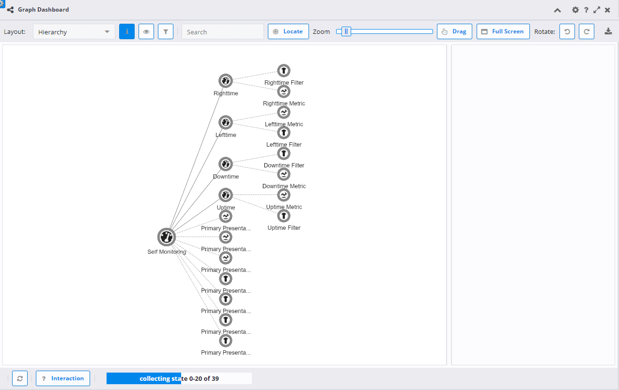

Circuit: a Force layout with a very linear set of nodes, and linear means there is a clear path from the beginning to end without many branches off of the main path.
Large Network: a Force layout that spreads clusters of tightly interconnected nodes away from each other.
Service: a Hierarchy layout designed to spread nodes evenly both vertically (siblings) and horizontally (parent to child).
Small Network: a Force layout to evenly spread a small number of nodes with an even distribution of edges.
Whole Network: a Force layout designed to maximize space between nodes with any number nodes and edges.

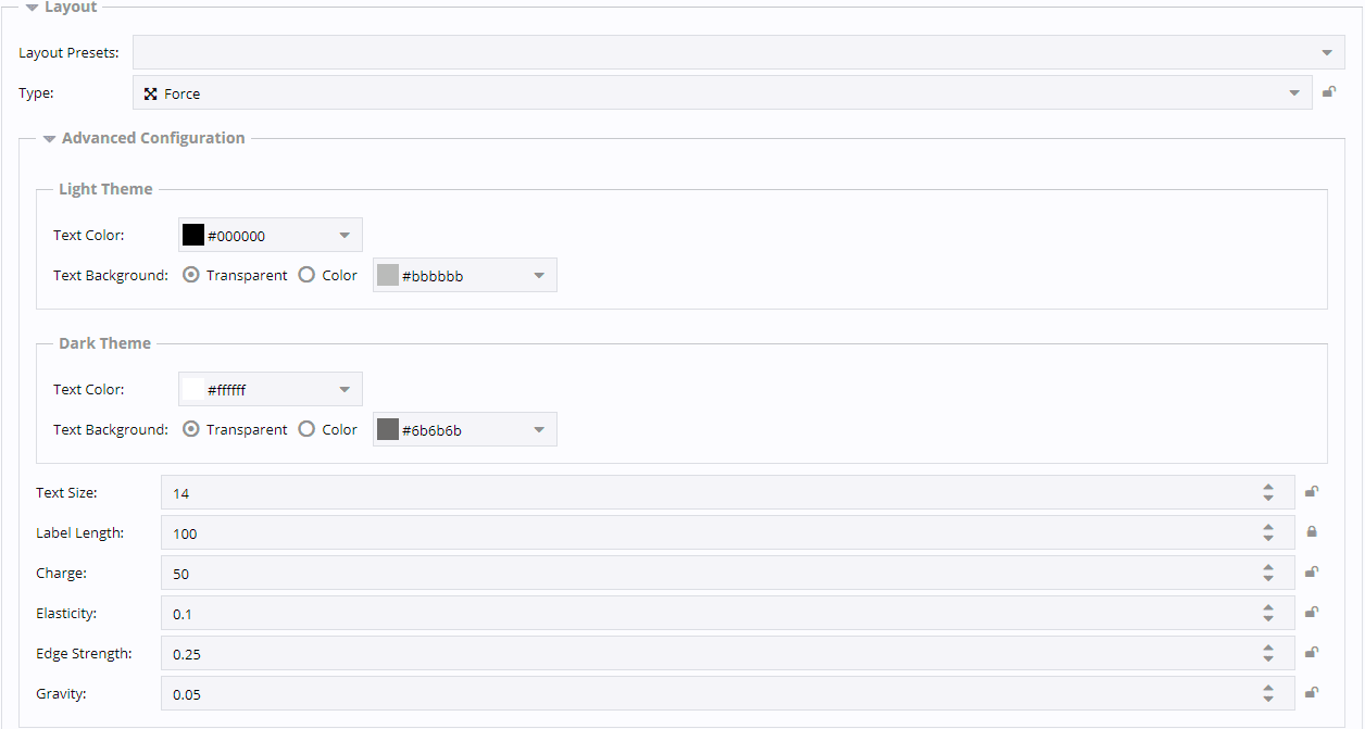

Type
This dropdown allows you to select a layout type. The possible types are Concentric, Force, Grid, Hierarchy, Radial, and Geographic Map. All of these layouts share some common Advanced Configuration options, but may also have unique options.
Common Advanced Configuration
Text Color: The color of the node and edge text. There are separate colors for light and dark themes.
Text Background: The node label background may be set to transparent or a specific color. There are separate colors for light and dark themes.
Text Size: The size of the node and edge text in pixels.
Label Length: The number of characters a vertex label will display by default. Anything beyond that length will be truncated unless the node is selected.

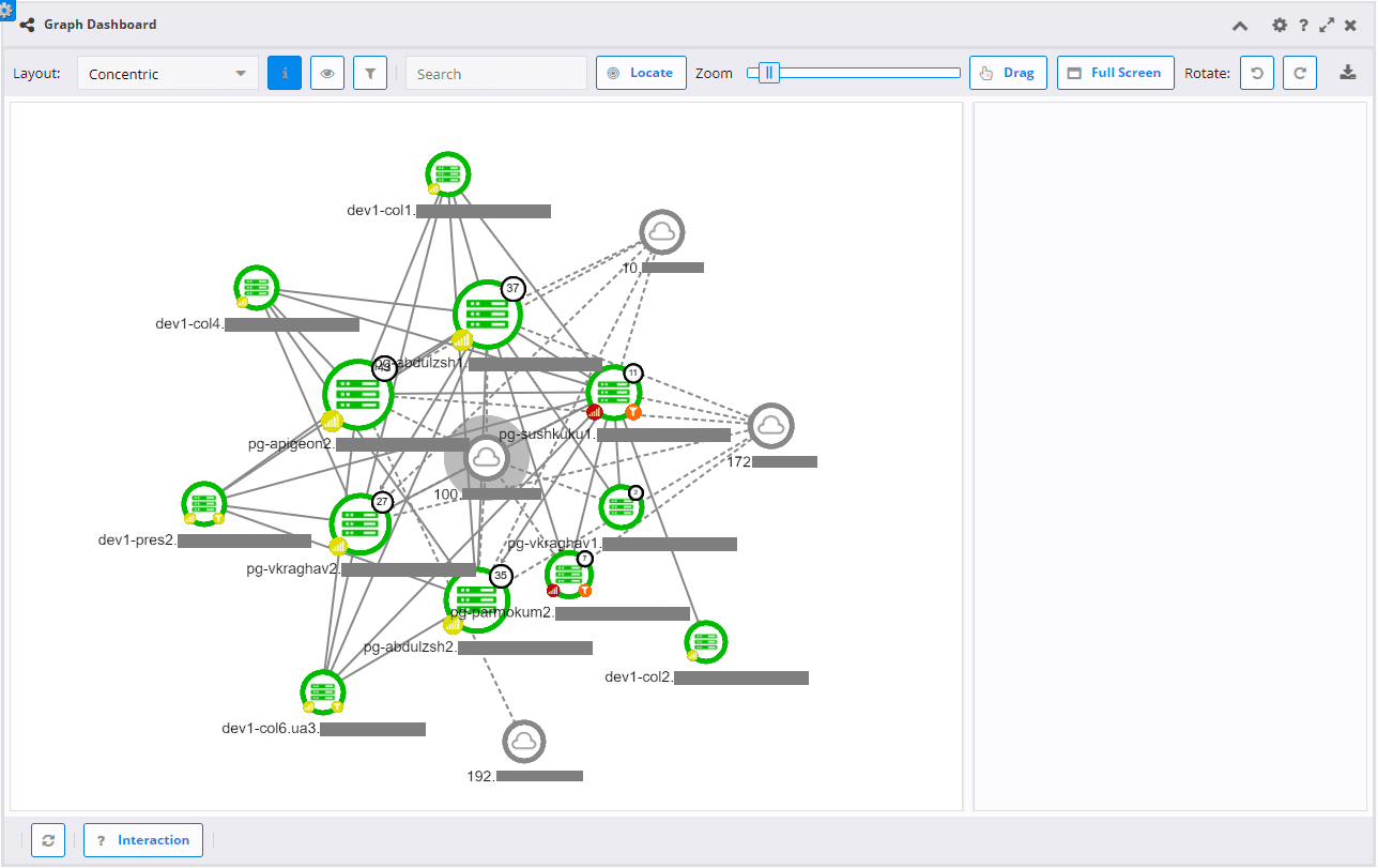

Concentric: This layout takes a base node as parameter and organizes the graph so the nodes close to the selected node are arranged in a circle around it. Each hop forms another circle.
Description of illustration topology-graph-dashboard-panel-form-layout-concentric.png

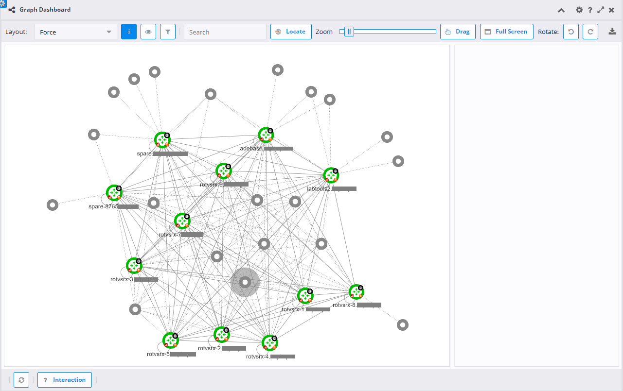

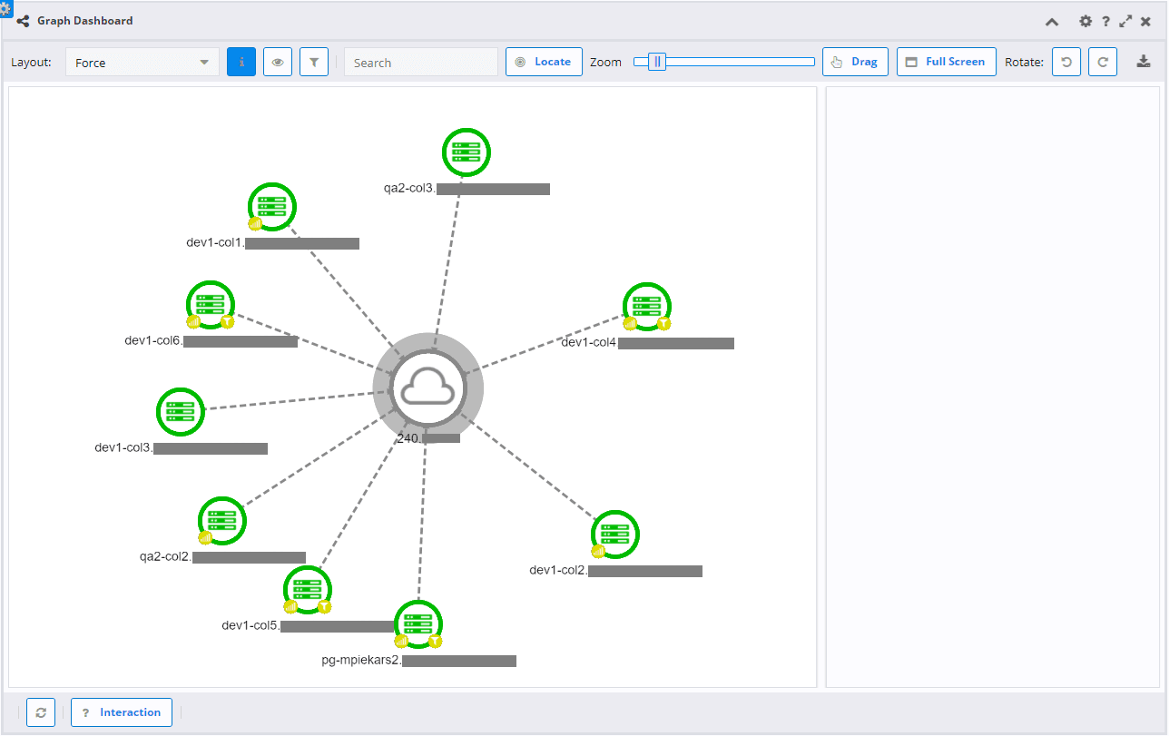

Force: This layout uses defined forces to attract or repel vertices from each other. The advanced configuration options will greatly affect the outcome, but the general layout will be spread out with the Gravity, Edge Strength, and Charge pushing the nodes apart.
Description of illustration topology-graph-dashboard-panel-form-layout-force.png
Charge: Distance factor between nodes. A greater value increases the distance.
Elasticity: Node collision elasticity. Smaller values may result in incomplete node overlap removal. Passing 0 will skip that algorithm pass altogether.
Edge Strength: Attraction strength. Higher values make edges' attractive force stronger.
Gravity: Force that attracts nodes to the center of the graph. Center is either the mass center of the graph or the value defined by cx and cy. Greater value makes the layout more compact.

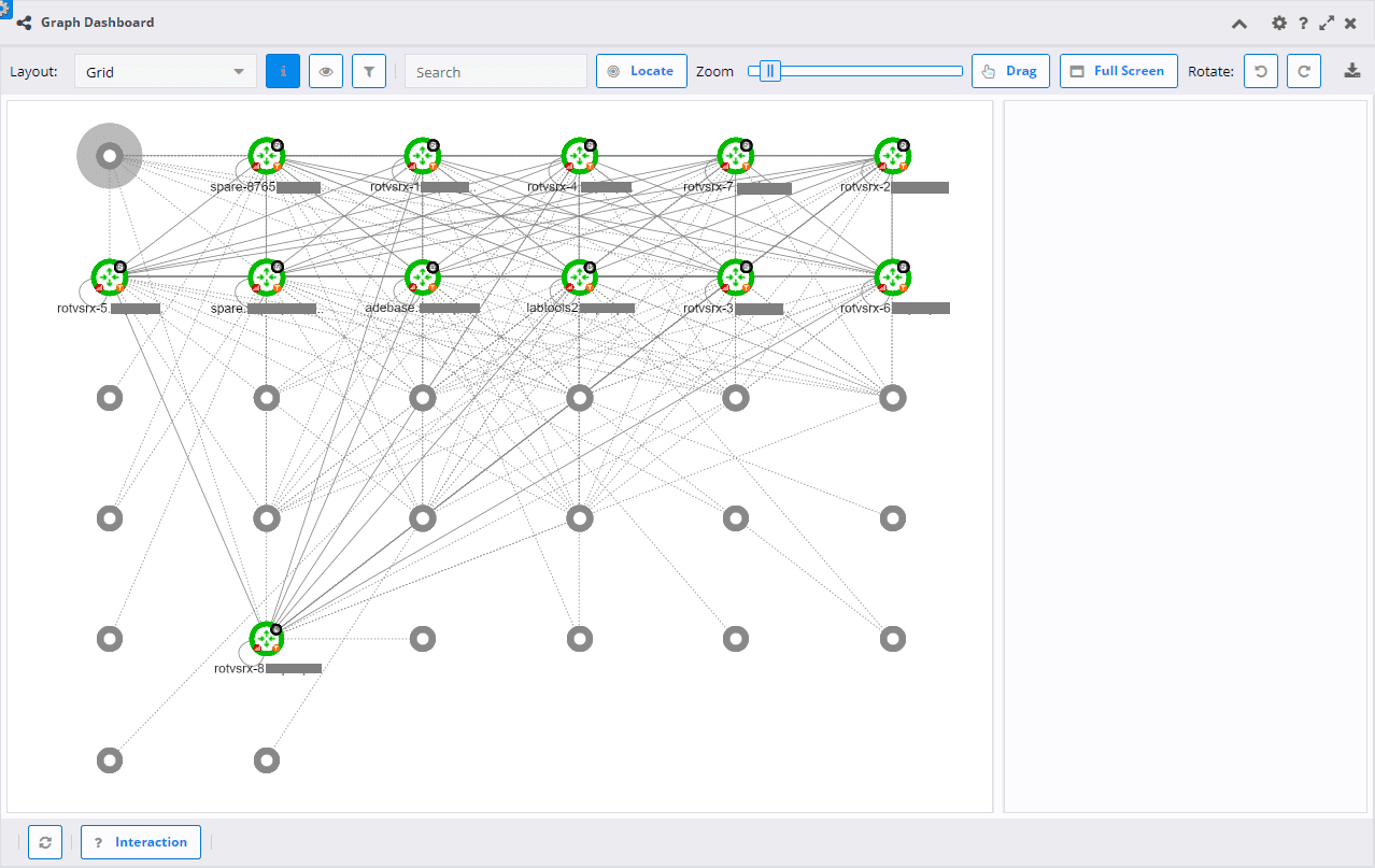

Grid: This layout arranges the vertices in a grid of rows and columns.
Description of illustration topology-graph-dashboard-panel-form-layout-grid.png

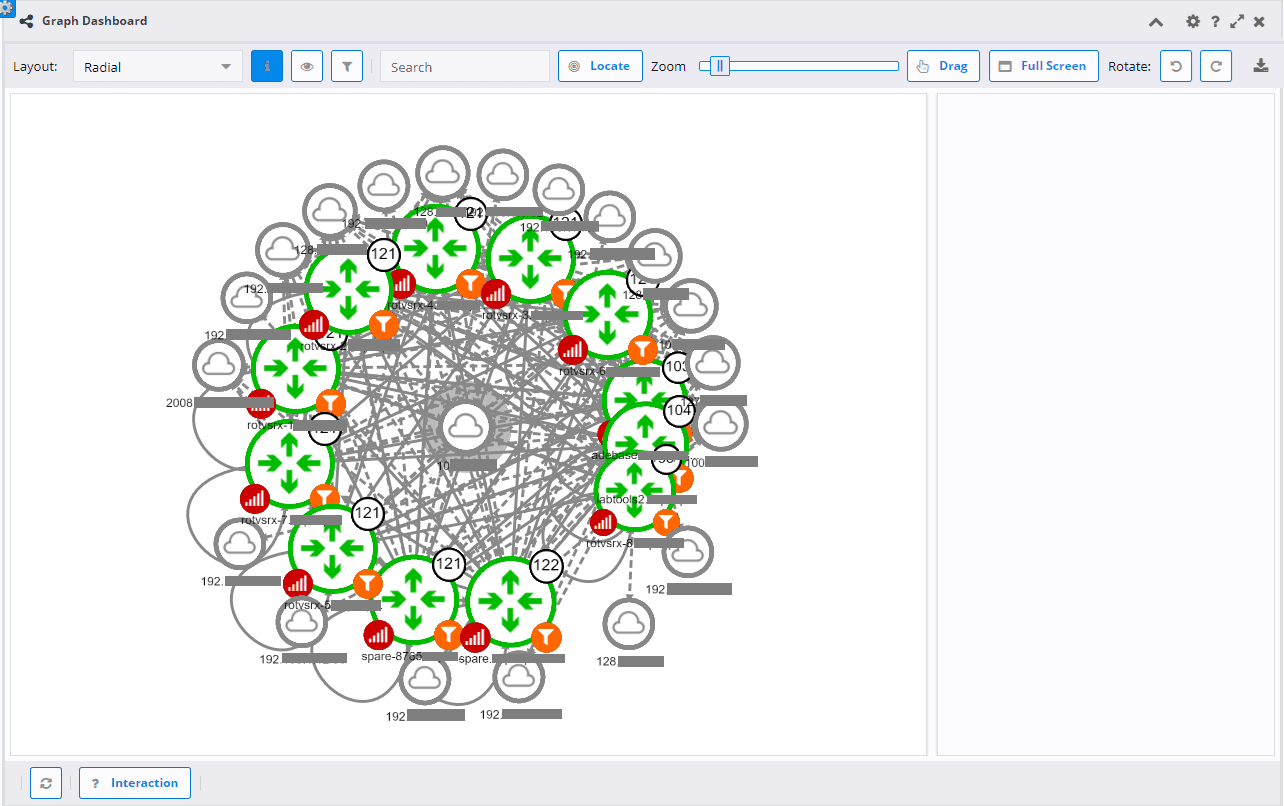

Radial: This layout positions nodes around the selected one based on their graph-theoretical distance (the shortest path in the graph, connecting them). If there are sub-graphs or nodes not reachable from the central node, they will be pushed outwards, but still placed around the layout in a readable way.
Description of illustration topology-graph-dashboard-panel-form-layout-radial.png
- Repulsion: Increase or decrease the repulsion force between the nodes on the same levels. Values smaller than 1 will result in more compact placement along the layers.

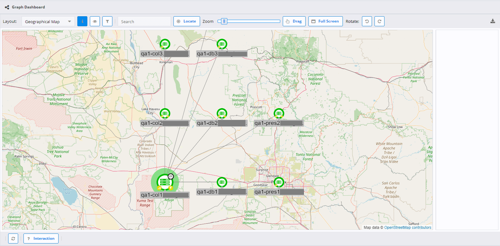

Geographic Map: This layout uses a geographic map as the background and places the nodes at their specified latitude and longitude. While in this mode, you can hold the shift key while clicking and dragging the mouse to select an area of the map to zoom in to.
Description of illustration topology-graph-dashboard-panel-form-layout-geographic-map.png
Measurement System: Apply the standard or metric system to the weather legend increments.
OpenWeather Map AppId: The application key to access OpenWeather Map data. The key is provided by https://openweathermap.org/ . Once a key is obtained by registering with the site, the key can be set as a global property or directly in the configuration form.
Geo Clustering Configuration: A grouping of fields related to enabling and configuring geo clustering, note fields will be display read-only in the case of an override existing for that configuration field
Geo Clustering: Enable or disable geo clustering of nodes.
Node Grouping: Enable or disable the default node grouping functionality. Enable this to group and tuck nodes on the geographic map according to the Group By and Tuck Away properties in the Graph section in addition to geoclustering them.
Radius: The size of radius around a node. Any nodes with overlapping radii are grouped together.
Properties: Add vertex properties to cluster only nodes with the selected properties.
Property Values: Add values for the selected vertex properties to further refine the clustering, only clustering nodes with the specified values.
The clustered nodes on the graph are labelled with the property name and value. When you select or hover a node on the graph, the vertex information window shows details for the cluster and all nodes in it.

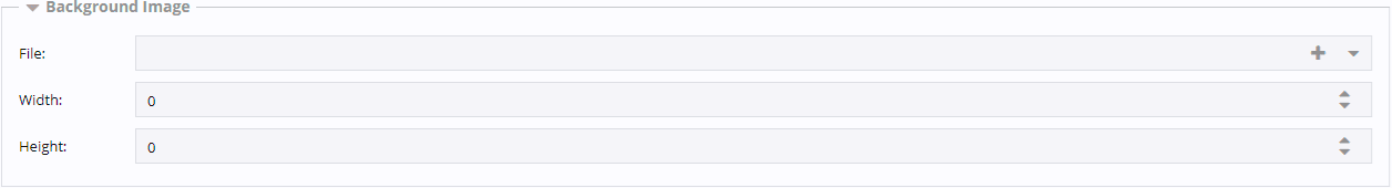

Background Image Settings
Description of illustration topology-graph-dashboard-panel-form-background-image-settings.png
File
An image file can be selected that will be displayed in the background of the topological view.
Width
After an image has been selected, the width of the file will be set here. The width can then be overridden to be larger or smaller as necessary.
Height
After an image has been selected, the height of the file will be set here. The height can then be overridden to be larger or smaller as necessary.

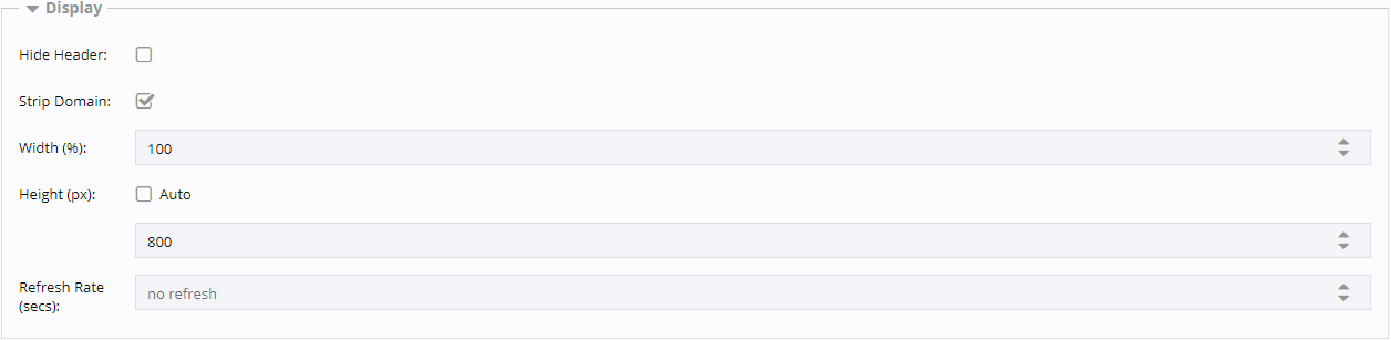

Display Settings
Description of illustration topology-graph-dashboard-panel-form-display-settings.png
Hide Header
This checkbox hides or displays the panel header when the panel is rendered. This is most useful for reports or if screen real estate is limited.
Strip Domain
This checkbox hides or shows the domain name on vertices. This is useful if there is only a single domain name so it is repetitive information, or the domain names are extremely long and make the node labels difficult to read.
Width
This indicates what percentage of the available screen width should be used for the panel.
Height
Auto will adjust the panel height as the content changes. This setting is generally not suggested for the topology because the graph will adjust the zoom to the height of the panel. Auto will default to 400px. If you want a different height, un-check Auto and set the desired height in pixels in the number field below the checkbox.
Refresh Rate
This allows the refresh rate to be set in seconds. This refresh rate determines how often the vertex details are updated. If no refresh rate is specified, the state will only load a single time when the graph is loaded.

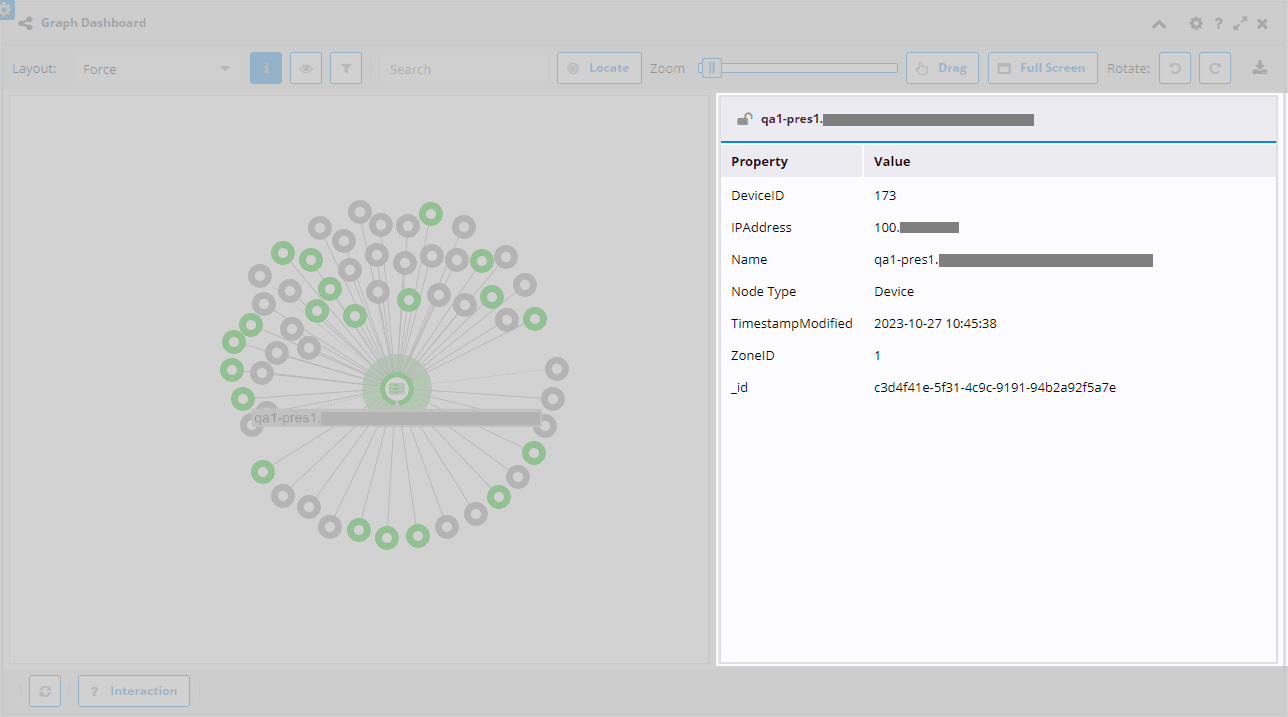

Topology Graph
The topology graph is the end result of the chosen selections. It consists of several different areas.

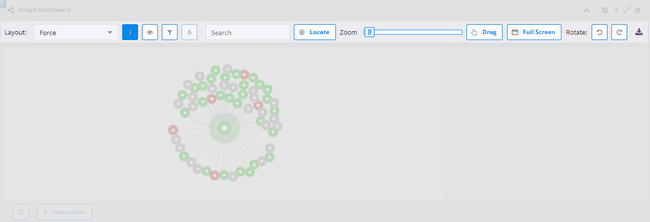

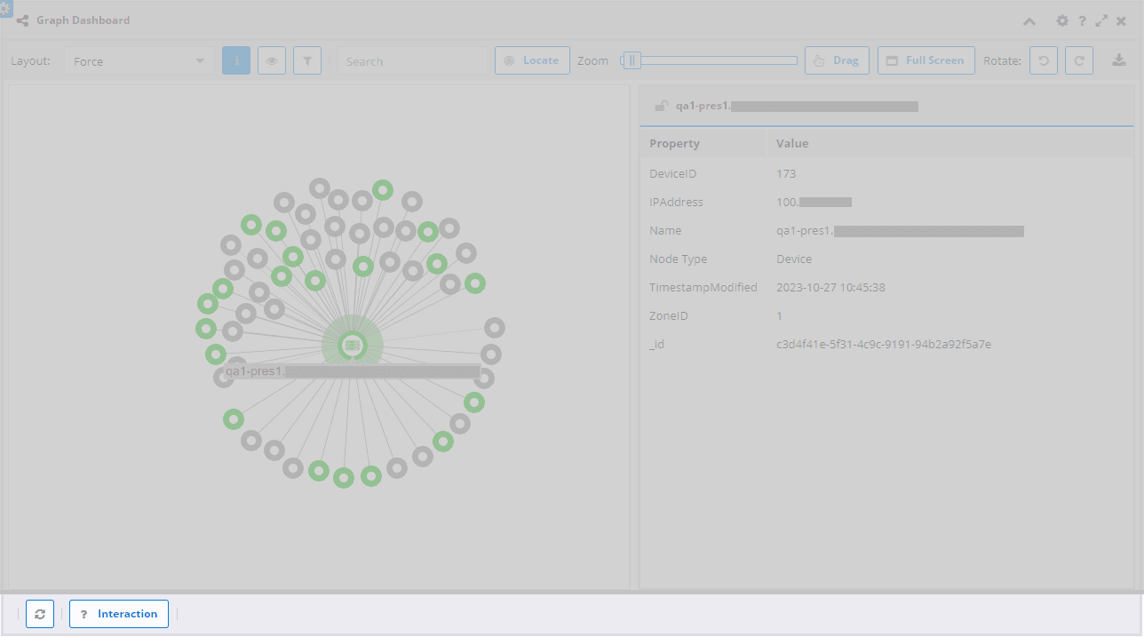

Toolbar
The toolbar is on the top of the graph containing various controls to modify the graph.
Layout
- This allows you to change the layout (Force, Hierarchy, etc) on the fly.

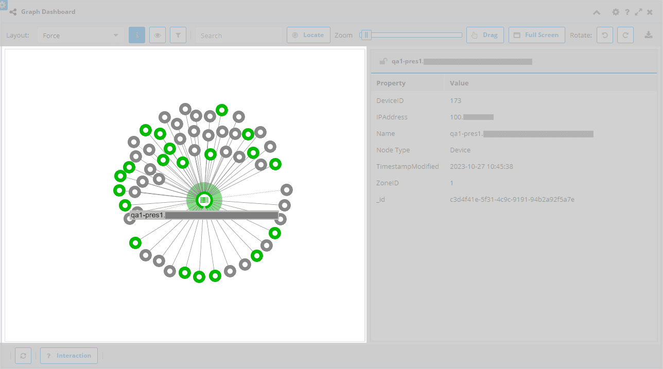

Toggle Selection Information
This allows you to toggle the information pane (the grid on the right side) on and off.
When the pane is turned off, moving the mouse over a vertex or edge will show the information in a pop-up window near the mouse cursor.
When the pane is turned on, the information stays in the same place on the right side.
If the pane is turned on and a node or edge is selected, the information will stay visible even if the mouse is moved away. This is ideal for selecting information of interest from the pane.

- Type in the Search field to highlight related nodes and/or edges quickly. Hit Enter to focus on just the related nodes and/or edges.
Locate
- Click Locate to focus on the Search values. If Search is empty, clicking this will bring the whole graph back into focus.
Zoom
- Use the slider to zoom in or out on the graph.
- You can hold the shift key while clicking and dragging the mouse to select an area of the map to zoom in to while in geographic layout.
- You can use the mouse wheel to zoom in or out in any layout.
Drag/Select
The text on this button changes between Drag and Select when clicked. These two options allow you to move or rearrange the graph layout manually.
When it shows Drag, you can click and drag the mouse on a node to move it or click-and-drag the background to move the whole graph.
When it shows Select, click and drag the mouse to select multiple nodes and/or edges.
Full Screen
- Click this button to hide the UI and just show the graph. This is ideal for monitoring stations or analyzing the graph layout. Hit Escape to exit full screen.
Rotate
- Each time one of these buttons are clicked, the entire graph will be rotated 45 degrees left or right. Vertex labels will remain properly oriented.
Export
- The export button allows you to capture the graph in the chosen export format. The export will just capture the graph area without the toolbar, information pane, etc.

The footer bar below the graph is mainly informational but has some interactivity.
Refresh
- The refresh button will reload the vertex detail information. This updates event counts, vertex availability, and metric threshold status.
Interaction
- This button opens a summary of how interactions with the graph work. Click anywhere off the summary pane to hide the information.
Update Status Bar
- When the vertices are being updated, it shows you a progress count. Once the update is complete, it will show status update complete for a few seconds before disappearing.
Information Pane
The information pane shows properties and values of the current target. You can drag the divider bar between the graph and the information pane to make it larger or smaller. Click the Toggle Selection Information button on the toolbar to completely hide it.
Description of illustration topology-graph-dashboard-panel-view-information-pane.png

Vertex
The large, central icon represents the vertex type, such as network, interface, or a device type. The color indicates the availability: red = 0%, green = 100%, and yellow is anything between.
The bottom left icon represents the metric threshold status. The color indicates the highest severity threshold breached.
The bottom right icon represents the event status. The color indicates the highest event severity.
The top right icon represents the number of vertices tucked away inside the vertex. If a number is present, double-click the vertex to expand it so the nested vertices are visible.

Example Process
Description of illustration topology-graph-dashboard-panel-example-process-form.png
Select a Start Vertex.
Set the number of Hops.
Set the Tuck Away to Interface.
Set the Text Background to Transparent for both themes.
Set the Label Length to an appropriate value.
Un-check Auto height.
Set the Height value in pixels.
Click the View button.
The result will look like this:
Description of illustration topology-graph-dashboard-panel-example-process-view.png
