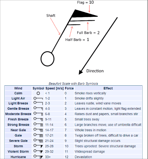

The following figure gives you an overview of the symbols used to show wind speed.

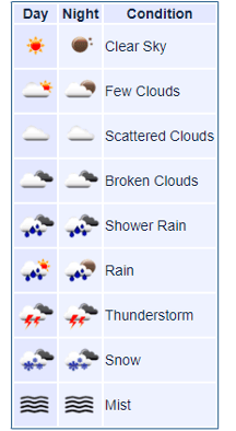

The following figure gives you an overview of the images of the weather symbols that are used.
