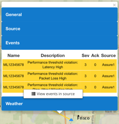

Events Tab
The events tab contains an event list with any events for that entity or link. Right-click an event to open a menu with a link to the full event list for the entity that is the source of the event. The following figure shows the menu for an event in the events tab:

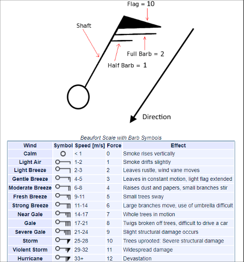

The following figure gives you an overview of the symbols used to show wind speed.

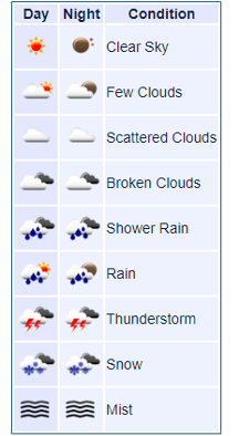

The following figure gives you an overview of the images of the weather symbols that are used.
