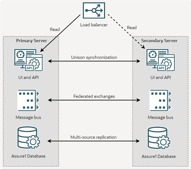

Internal Presentation Server Scalability and Redundancy
The internal presentation servers encompass the web user interface, the API, rules repository, image repository, package repository, dashboard integrations, and message bus. The first server installed is considered the primary presentation server, and you can install one additional redundant internal presentation server. The internal presentation servers are considered stateful because the Unified Assurance management database is collocated with them.
Redundancy of the internal presentation servers is provided as follows:
The Unified Assurance database is configured with MySQL multi-source replication. Unique table IDs are separated into even and odd pairs between the servers. This allows for a repair of a split-brain scenario to be conflict free and provide eventual consistency.
RabbitMQ message bus redundancy is enabled by configuring federation to replicate exchanges between both servers.
Package installation is mirrored between servers based on the configured roles but installed independently.
Configurations outside of the database and repositories are synchronized with Unison, a bi-directional application that uses the rsync protocol. Unison may encounter conflicts after the repair of a split-brain scenario but will never overwrite data until the authoritative files are manually identified.
As a best practice, the WebFQDN is defined in DNS to a Virtual IP (VIP) that can fail over between the two servers. You can achieve this by:
Using KeepAlived in the same data center and network
Setting up a load balancer in Layer4 mode instead of Layer7 to perform failover.
Unified Assurance uses TLS client certificate authentication and must terminate the secure session instead of the load balancer offloading this responsibility. The load balancer needs to perform cross data center failover and must also be redundant.
The following figure illustrates a redundant deployment for the internal presentation servers using a load balancer.
Users access the internal presentation servers by the web fully qualified domain name (WebFQDN) configuration option. In a single server development instance, the WebFQDN is commonly the same as the HostFQDN, but you can set the WebFQDN to any valid FQDN as a vanity URL. You must be careful when choosing a WebFQDN that is different than the HostFQDN, especially when redundancy is enabled. As a best practice, redundant pairs should share a WebFQDN.
Your internal and external presentation servers can share the same WebFQDN, or they can use a different one. In redundant environments with a VIP, the redundant pair of internal presentation servers should share a WebFQDN, and the redundant pair of external presentation servers should share a WebFQDN, but the internal and external WebFQDNs can be different.
In environments without a VIP, the internal presentation servers can each have a separate WebFQDN, but several components (SVN, API calls, image repository, package repository) can only support a single destination. Because of this, you can only achieve partial presentation server failover with separate WebFQDNs, so changes should be minimized.

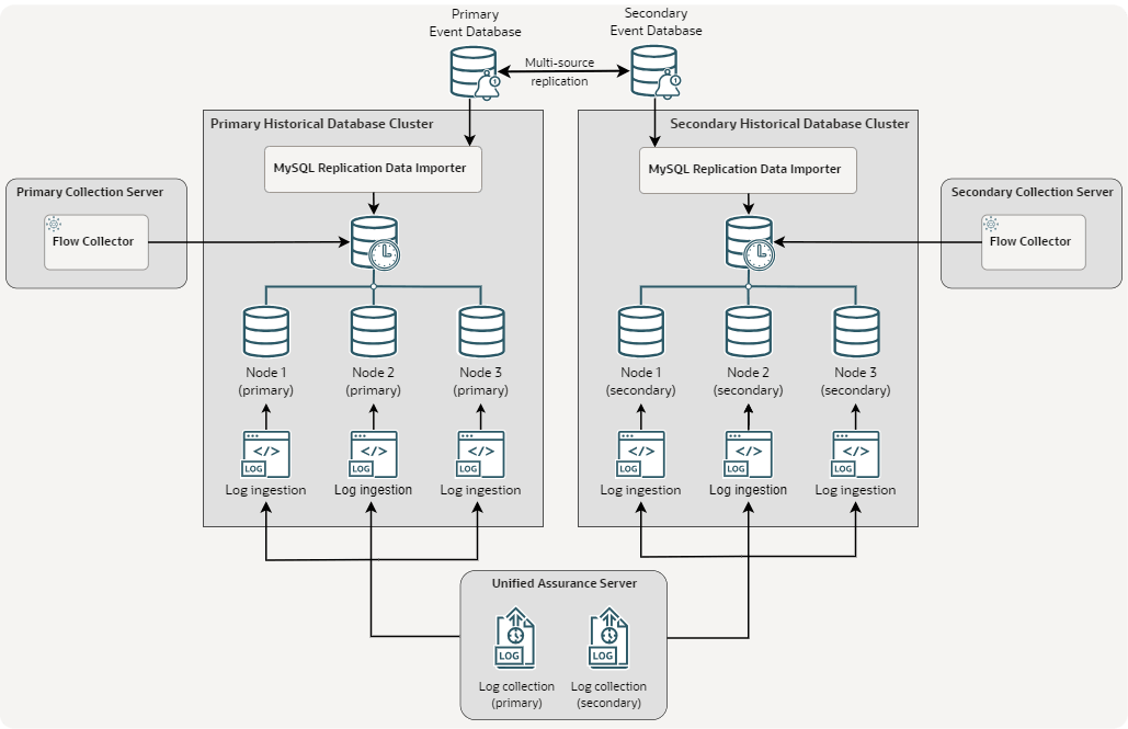

Historical Database Scalability and Redundancy
The Historical database is stored in OpenSearch, and includes index templates for Observability Analytics, Flow Analytics, and Log Analytics.
Scalability: You scale OpenSearch by adding additional servers to existing clusters. You do this when you run Analytics Wizard on the new server, after installing Unified Assurance.
Flow Analytics scalability is achieved using the microservice cluster. You can have Flow Collector pods running on multiple clusters with flow data exporters sending data to different clusters to balance the load.
Redundancy: Redundancy for the Historical database is handled in different ways for different indexes. In all cases, the redundant Historical database clusters both operate simultaneously but independently, each receiving events, flows, and logs from their corresponding primary and secondary services. A cluster is considered healthy when at least two out of three nodes are running. The services that send data to the Historical database (MySQL Replication Data Importer, the Flow Collector microservice, and Fluentbit) automatically find an active node to send data to. This allows you to achieve high availability within the cluster
For Observability Analytics redundancy, the Historical database uses the Event database, which synchronizes events between the primary and secondary Event databases by multi-source replication. The primary MySQL Replication Data Importer synchronizes events and journals from the primary Event database to the primary Historical database, and the secondary instances follow the same pattern.
If the primary Historical database goes down, the primary MySQL Replication Data Importer cannot insert events. It stops processing events, and retries every thirty seconds. The secondary Historical database continues to receive events from the secondary Event database. When the primary comes back online, the primary MySQL Replication Data Importer starts synchronizing events from the Event database from the point where it left off.
If the primary Event database goes down, it fails over to the secondary Event database. The primary Historical database remains online, but MySQL Replication Data Importer stops getting events, while the secondary Historical database continues to get events from the secondary Event database. When the primary Event database comes back up, all events that occurred while it was down are synchronized to it from the secondary Event database, and MySQL Replication Data Importer begins getting events from the point where it left off.
For Flow Analytics redundancy, you deploy the Flow Collector microservice to redundant collection servers. Each flow data exporter sends the same data to both primary and secondary Flow Collectors. If the primary Historical database is down, the primary Flow Collector tries three times to send the data, then discards it. The secondary Flow Collector continues to send the data to the secondary Historical database. When the primary database comes back up, the primary Flow Collector starts inserting data from that point. Any flow data that the primary Flow Collector received while the database was down is lost on the primary Historical database, but present on the secondary.
For Log Analytics redundancy, the Historical database uses redundant instances of Fluentbit. Two instances run on each Unified Assurance server, sending identical log data to the Fluentd services on the primary and redundant OpenSearch clusters. If at least two nodes on a cluster are running, Fluentbit continues to read log data and send it to Fluentd on that cluster. If one or no nodes are running, that instance of Fluentbit stops reading log data. Because the redundant instance continues to read and send logs to the redundant cluster, no data is lost. When the cluster stability is restored, Fluentbit resumes reading logs and sending them to the cluster, starting from where it left off.
The following figure illustrates a deployment for the Historical database with three-node redundant clusters, receiving event data from the Event databases, and receiving log and flow data from other Unified Assurance servers. Each Historical database node, along with every other server in the environment, would also have redundant instances of Fluentbit running to collect logs and send them to Fluentd instances on both clusters, but these have been omitted from the figure for simplicity.

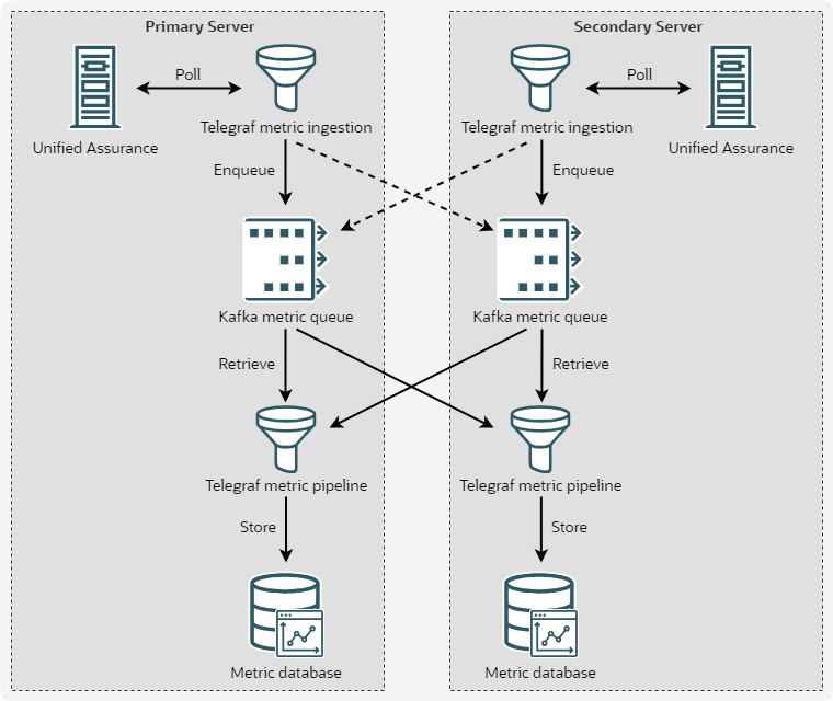

Metric Database Scalability and Redundancy
The Metric database is stored in InfluxDB, a time-series database.
Scalability: The Metric database uses sharding for scalability.
You implement sharding by metric by configuring devices with a specific shard ID, which is defined for each database instance or pair of redundant instances. Unlike with event collectors, metric collectors and pollers send metrics to the appropriate shard without needing to be configured in Unified Assurance directly. Each Unified Assurance server has an instance of Telegraf, which polls the local system and batches metrics to the appropriate Metric database instance.
Redundancy: You implement redundancy for the Metric database by linking Kafka message buses to the ingestion pipeline.
The Telegraf instance on each server sends metrics to the Kafka message bus instead of directly to InfluxDB. Telegraf fails over to the redundant Kafka server as needed. You install an additional Telegraf instance on each metric server to read from both primary and redundant Kafka message buses and batch insert those metrics into the local InfluxDB server. This redundancy handles failovers and split-brain scenarios to provide eventual consistency of data between both InfluxDB servers.
If the normal Kafka and Telegraf recovery flow does not restore retained metric data, see Recovering Metric Data from Kafka Logs for the optional manual recovery procedure.
The following figure illustrates a redundant deployment for the Metric database.
