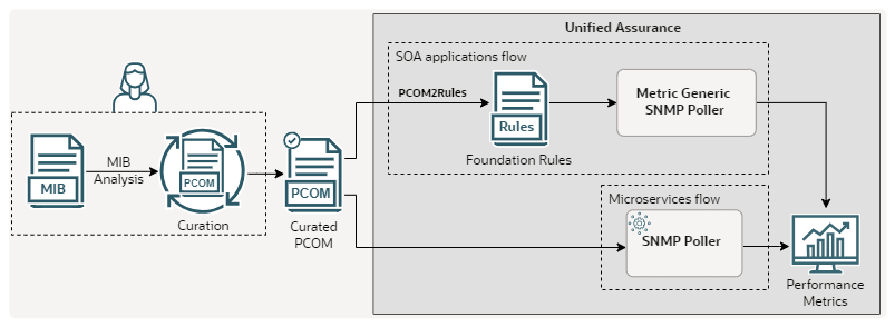

Performance Support Workflow
Performance support starts with Management Information Base (MIB) files. MIBs are structured collections of information in a hierarchical format that define the characteristics and status of network devices in the form of objects and object tables.
An object is a specific piece of data or resource that can be managed or monitored on a network device. These network devices are monitored using SNMP.
You must go through MIBs related to the devices you want to get metrics for, and find the relevant objects and object tables. PCOM curation is the process of adding relevant information from the MIB file to a PCOM file and arranging it in a proper manner. Once you have arranged objects in the PCOM file and configured them properly, the PCOM curation is complete and the file is ready to be tested.
There are two different flows for testing:
The PCOM file is directly used by the SNMP Poller microservice to poll device information and help in generating performance metrics. See SNMP Poller in Unified Assurance Implementation Guide for more information.
The PCOM file is converted into foundation rules, which are Perl definitions of how the PCOM file information shall be executed. These foundation rules are used by the Metric Generic SNMP Poller, which is a Service Oriented Architecture (SOA) application, to poll the device and get the metrics. See Foundation Rules and GenericSNMPPollerd in Unified Assurance Implementation Guide for more information.
