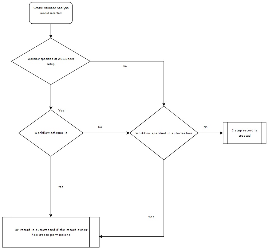

For Workflow BP, when By Pass I-step selected, the following process takes place:
This flowchart depicts the workflow BP process that bypasses the I-step.
