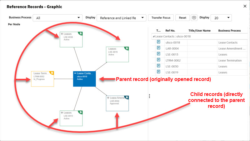

    When you first open the graphic, it displays the original parent record that you opened, along with all child records that are directly attached to it. Child records are color coded based on their BP type. If you hover over a record, the system will display the type of record, record number, and record status. The direction of the connection is indicated by a gray arrow, pointing from the parent record to the child record.
This is an image of what the reference records graphic looks like when first opened. The parent record is highlighted in blue and the child records that are directly connected to the parent are displayed, with a gray arrow pointing to each child.
On the right pane is a log that displays all the visible referenced records, as well as linked records and line items. Each parent record has a list of all connected child records underneath, which can be collapsed or expanded by selecting the gray arrow next to the record name. The icon in the first column indicates the type of connection that exists between records. If it is a referenced record, a blue page icon "" is displayed. If it is a linked record, a blue link icon "" is displayed. If it is a linked line item, a yellow link icon Liked line item icon. is displayed.
