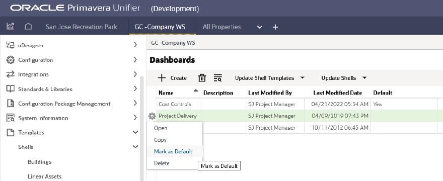

Administrators can set a default dashboard within shell templates. A shell template can have only one default dashboard.
Sample Description
This image displays the default column of the Dashboards log. There is a column titled "Default" set to "Yes" for the dashboard that was the default prior to this upgrade.

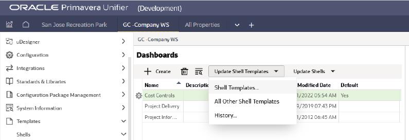

A default dashboard can be pushed to some or all shells using Update Shell Templates.
When creating a new shell – whether by copying from a Template, copying from a Shell, through a Project/Shell Creation BP, or through REST services using a Shell Template – checking the "Dashboard Setup" option will cause the default setting for the custom dashboard setup to be copied into the newly-created shell.
