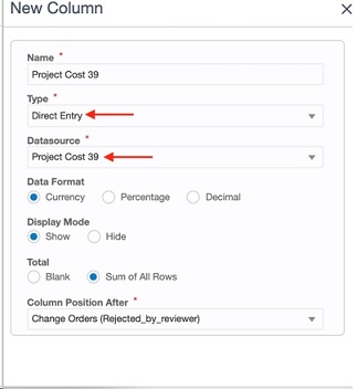

This method is only supported for cost sheet columns. The Get Column Data Web Services call method will only fetch data for the following combination of Type and Datasource:
(1) Type = Direct Entry and Datasource = Project Cost (1 - 100)
(2) Type = Line Item Content and Datasource = Project Cost (1 - 100)
(3) Type = Line Item Content and Datasource = AFC
(4) Type = Line Item Content and Datasource = YTB (Yet To Buy)
