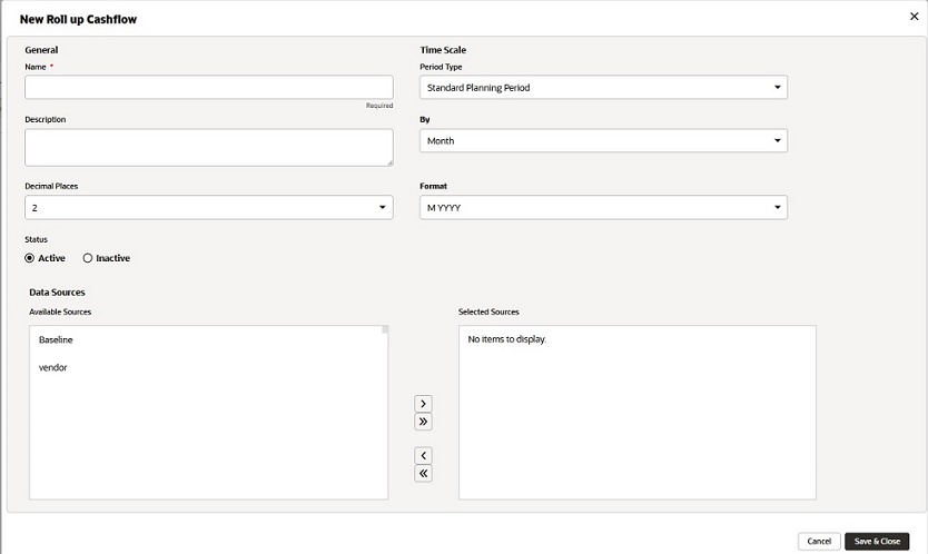

  3. From the toolbar, select Create, and select Roll up Cashflow to open the New Roll up Cashflow window, as shown below.
  4. Proceed to complete the fields in the New Roll up Cashflow window.
    The Data Sources block lists the available sources for you to select.
  5. When finished, select Save & Close. to add the new Roll up Curve to the Cash Flow log.
This image displays the new roll up cashflow window.
