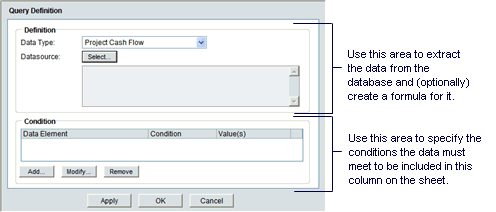

  2. In the Entry Method field, choose Query, and select Define. The Query Definition window opens.
    Use this area to extract the data from the database and (optionally) create a formula for it. Use this area to specify the conditions the data must meet to be included in this column on the sheet.

  6. Specify the query condition as follows:
    1. Select Add. The Query Condition window opens.
