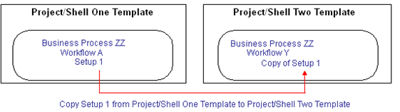

Copy a Setup from One Project/Shell Template to Another
In this copy action, you copy a setup from a business process in one project/shell template to the same business process in another project/shell template.
Copy Setup 1 from project/shell one template to project/shell two template.
To copy a setup from one project/shell template to another:
