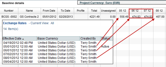

In the Baseline details example that follows, you can see differences in values due to future exchange rate conversions.
  • The transaction currency is INR.
  • The project currency is EUR.
  • The distribution is linear.
  • The distributed values are 37,000 INR per time period.
  • May and June rates take effect on the first of the month, respectively.
  • A July future exchange rate takes effect in Unifier on 07/02/2012, so the system continues to display the value of the June rate in the cash flow.
  • The August rate shows up in the cash flow curve on 08/01/2012.
    This image displays how exchange rates affect baseline details.
