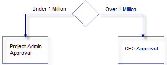

This graphic displays how a condition can trigger two different steps if the amount is more or less than a set amount.
When the workflow reaches a conditional step, the business process tests the value of the field on the form to see whether it meets the trigger value.

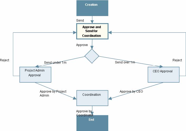

    You can include multiple conditional routings in a workflow, but only one condition per step.
    This image depicts an example conditional workflow.

    2. In the Conditional Name field, enter a name for the action of the conditional link; for example, "Under 1 Million" to route an invoice approval to one authorizer, or "Over 1 Million" to route it to another authorizer.
