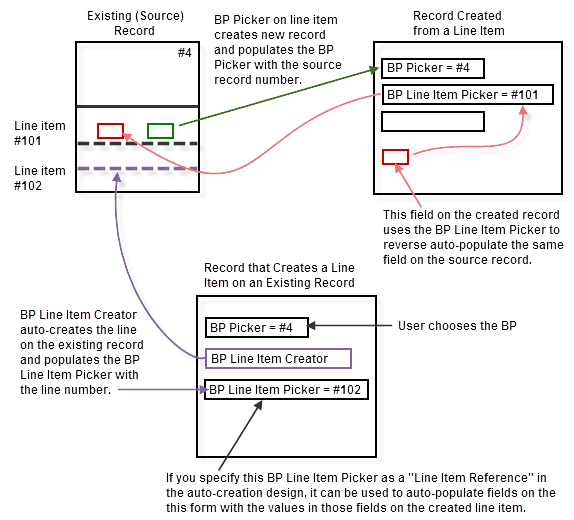

Line-Item-to-Record Auto-Creation
Line-Item-to-record auto-creation has the following characteristics:
  • Each line item that contains a creator element will auto-create a new record. For example, if source tab A has a creator element on 10 line items, and source tab B has the same creator element on 7 line items, 17 new records will be auto-created.
    Sometimes creating a record for every line item is cumbersome. You can end up with 17 records that differ in only one aspect, such as a color. For cases like this, administrators can group line items for auto-creation to create fewer generated records. In a simple example for a lumber yard order, you might have doors made of wood or steel, both in colors of white and red. You could group the line items according to the material (wood or steel) and color (red or white) to create fewer work order records. This kind of grouping for auto-creation is set up by the Unifier administrator. For more information about setting up business processes, refer to the Unifier Modules Setup Administration Guide.
  • The source record populates any upper form fields on the destination record that the two records have in common.
  • You can use line items on the source record to populate fields (data elements) on the upper form of the new record if the data element names match.
  • If you map the contents of any tab on the source record to tabs on the new record, this type of auto-creation will also copy the line items of those mapped tabs to tabs on the new record. The tab names do not have to match. The source line items will populate any fields that the tabs on the destination record have in common with it.

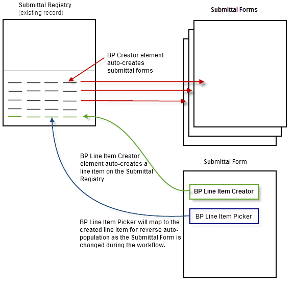

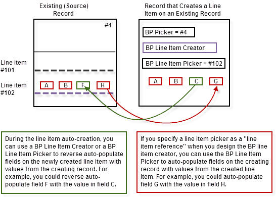

Line item auto-creation is useful for adding new line items to an existing record. For example, a submittal registry record could contain line items that auto-create separate submittal business process forms for each contractor on a project. In the course of work, someone might realize that the original submittal registry record is missing a submittal for an architectural drawing. That person could submit a new submittal record that would add the missing architectural drawing submittal to the original registry record.
uDesigner provides a BP line item creator element to auto-create line items. You can place this creator element on either an upper or detail form. This element will auto-create a new line item on another, existing, record and populate the fields of that line item with the values of the fields on the form (upper or detail) that auto-created the line item.
You can set up reverse auto-population so that the line item added to the existing record can be updated with information as the record that created the line item moves through subsequent steps in a workflow.
This image displays how reverse auto-population works between workflow steps.
How Creator Elements and Pickers Function in Line Item Auto-Creation
Pickers and creator elements work together to auto-create line items.
This image displays how pickers and creator elements auto-create line items
Auto-Population and Reverse Auto-Population in Line Item Auto-Creation
To populate and reverse auto-populate fields on business processes and line items with line item creation, you can use the following data elements in collaboration:
  • BP Line Item Picker
  • BP Line Item Creator
This image displays how auto-created line items are populated.
