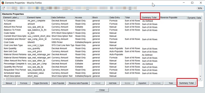

If you add a DE "refid" that has been configured to point to a Base Commit BP of SOV type Summary Payment Applications to the Upper Forms of a Cost-type BP (sub-type: Line Items with CBS Code and classification: Payment Applications), the Elements Properties window (of the Detail Form) displays these additional elements:
  • Summary Total column (appearing after the 'Total' column, highlighted on the image below)
  • Summary Total option (at the bottom of the window, highlighted on the image below)
    The Summary Total option is only available to define the Summary Total calculation for the Payment Applications of SOV Type = Summary Payment Applications. This option is not available for Payment Applications Business Process (BP) or any other BP types. Also, if the DE "refid" has not been configured to point to the Upper Forms, or it has not been configured to point to some other type of BP, the Summary Total option will not be available.

This image displays the properties window of the detail form.
When you select DEs that only correspond to the Decimal Amount, Currency Amount, or Integer Amount Data Definitions (DDs), the Defining Summary Total for Column window opens which enables you to select the following options under in the Summary Total block:
  • As Defined
  • Sum of All Rows
In the Defining Summary Total for Column window:
  • If the Data Entry for a Data Element is set to Manual, the option of Sum of All Rows is selected, by default.
  • If the Data Entry for a Data Element is set to Formula or Auto-Populate, the option of As Defined is selected, by default.
    If the DE is set as Formula, select the option As Defined for Summary Total.
