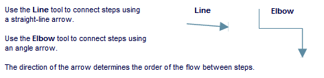

You can link steps using two types of connectors:
Use the line tool to connect steps using a straight-line arrow. Use the elbow tool to connect steps using an angle arrow. The direction of the arrow determines the order of the flow between steps.

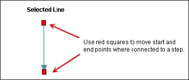

To modify a line:
  1. Select the Select tool, and then select the line you want to modify.
  2. Select and hold the red squares to move the start and end points of the line.

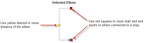

To modify an elbow:
  1. Select the Select tool, and then select the elbow you want to modify.
  2. Select and hold the yellow diamond to expand the distance of the elbow, or select the red square to move the start and end points connected to the step.
Use yellow diamond to move distance of the elbow. Use red squares to move start and end points.

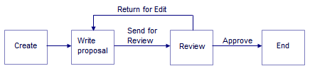

Each link between steps denotes the progression of the business process through the workflow.
This image shows an example workflow.
The action the link takes (Approve, Return for Edit, and so on) appears in Unifier as a choice the user makes on the business process form. This choice moves the task to the next step.

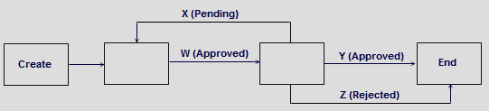

    This image shows an example workflow leading to the terminal step.
  • Statuses assigned to links Y and Z must be terminal; they reach the end step.
  • If link W has a terminal status (Approved) and link X has a non-terminal status (Pending), the workflow will produce an error because the status of the step changed from a terminal to a non-terminal status.
  • Likewise, if link W has a terminal status (Approved) and link Z has a terminal status (Rejected), the workflow will produce an error because the record changed from terminal status Approved to terminal status Rejected.
