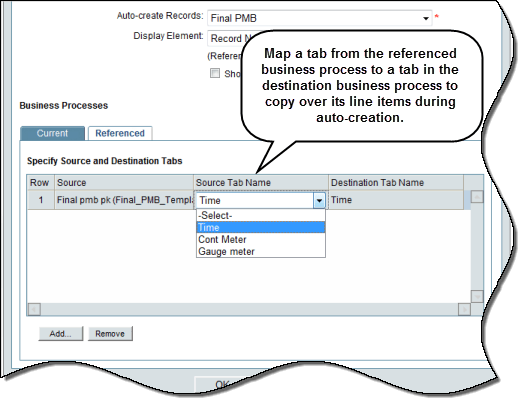

To configure line item mapping in upper or detail form:
  1. Go to the Company Workspace tab, and switch to Admin mode.
  2. In the left Navigator, select uDesigner, and then select Business Processes.
  3. Open the applicable line item type BP in which you want to set up line item mapping from a referenced business process to an auto-created business process.
  4. In the left Navigator, select Auto-creation Processes, and then select Upper or Detail.
  5. From the toolbar, select New to configure auto-creation on the selected BP Creator field placed on the upper or detail form.
  6. Complete line item mapping in the Referenced tab, associating tabs in the source business process to tabs in the destination business process.
Map a tab from the referenced business to a tab in the destination business process to copy over its line items during auto-creation.
