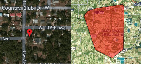

Map panels display objects having a discrete location, such as a meter, as a single point on the map, which is indicated by a pin; for types that have an area or territory, the map displays the location as a shaded polygon.
Map panel displaying a sinle meter point

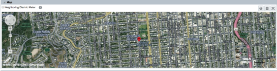

When an object is selected, opening the map panel will center the object in the map.
The two map panel views: A single, red pinpointed geographic location, and a shaded polygon for the region covered by the territory or area.

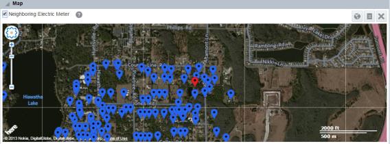

Meter Data
The Map panel for meters opens with the meter centered in the map. Neighboring meters can be added to the meter view.
To see neighboring meters, click the Neighboring Electric Meter checkbox.
Note: The map will only show geopoint data of meters for which there is data available. For example, if there are five meters in an area but only data available for two of them, the filter results will list all five meters, but only the two results with available data will appear in the Map panel.
The map panel view of meter data displaying a single, red pinpointed meter surrounded by blue neighboring meter pinpoints

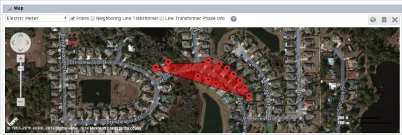

  • To view the child meters connected to the transformer, click the Neighboring Electric Meter checkbox. The map shows only the connected meters. It does not show meters that are within the boundary of the line transformer, but not connected to it.
    Map view of line transformer data displayed as a red polygone covering the supplied area of the map with child meter points

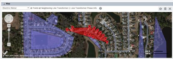

  • To view the adjacent transformer polygon, click the Neighboring Line Transformer checkbox.
    Map view of line transformer data displayed as a red polygone covering the supplied area of the map with child meter points, and adjacent transformers indicated by purple polygones

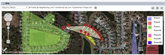

  • To view adjacent transformer polygons color-coded by phase, click the line Transformer Phase Info checkbox.
    Note: Phase coloring is only available in the Distribution Planning and Operations module.
    Map view of line transformer data displaying adjacent transformer polygones color coded by phase
