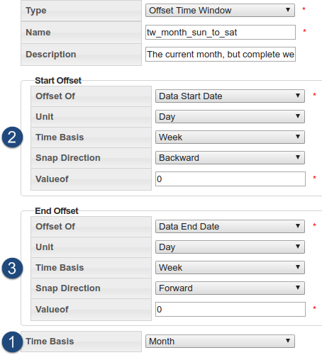

Offset Time Windows
The offset time window allows you to create a time window that is offset from the start and/or end dates, which are input when the filter is ran.
Note:  When you run the filter, you select the start and end dates. For reference purposes, these will be known as Data Start Date and Data End Date.
Offset Time Window dialog box
Image Number | Section Description
1 | Time Basis
The Time Basis field sets the data boundary snapping prior to offset snapping.
For example, to look at complete weeks (that is, the start date should be a Monday and the end date should be a Sunday) for the current month.
2 | Start Offset
The Start Offset settings allows you to move the analysis date by a selected time basis unit (for example, day or month). You may also "snap" the offset backward or forward in time.
  • Offset of: Set whether the offset will be performed on the data start date or data end date.
  • Unit: Set how the units by which the dates will be offset when Valueof is set.
  • Time Basis: Post-snapping time basis.
  • Snap Direction: Snap direction sets whether the start offset will expand backward in time or forward.
  • Value of: Number of units to be offset by.
3 | End Offset
The End Offset is similar to the Start Offset with the exception that the resulting date must be later than the Start Offset date.
  • Unit: Set how the units by which the dates will be offset.
  • Time Basis: the post-snapping time basis.
  • Snap Direction: Snap direction sets whether the end offset will expand backward in time or forward.
  • Value of: Number of units to be offset by when Value of is set.
Elements
Image Number | Element Name Description
1 | Pre-snapping Time Basis The pre-snapping time basis snaps the input time range to be a range of months
2 | Start Offset Post Snapping
The start offset's post that snaps the start date backward to the beginning of the week (Sunday).
3 | Eng Offset Post Snapping
The end offset's post that snaps the end date forward to the end of the week (Saturday)
For example, if you were to use the preceding Offset Time Window criteria to input a date range of February 3rd, 2016 (Wednesday) - February 4th, 2016 (Thursday), the resulting date range for analysis would be:
  • The Time Basis has a pre-snap of Month, which gives us the month of February.
  • The Start Offset Time Basis is Week and it snaps backward to give us Sunday, January 31st.
  • The End Offset Time Basis is Week and it snaps forward to the end of the week containing February 29th, which is Saturday, March 5th.
The final date range is then Sunday, January 31st, 2016 - March 5th, 2016.
