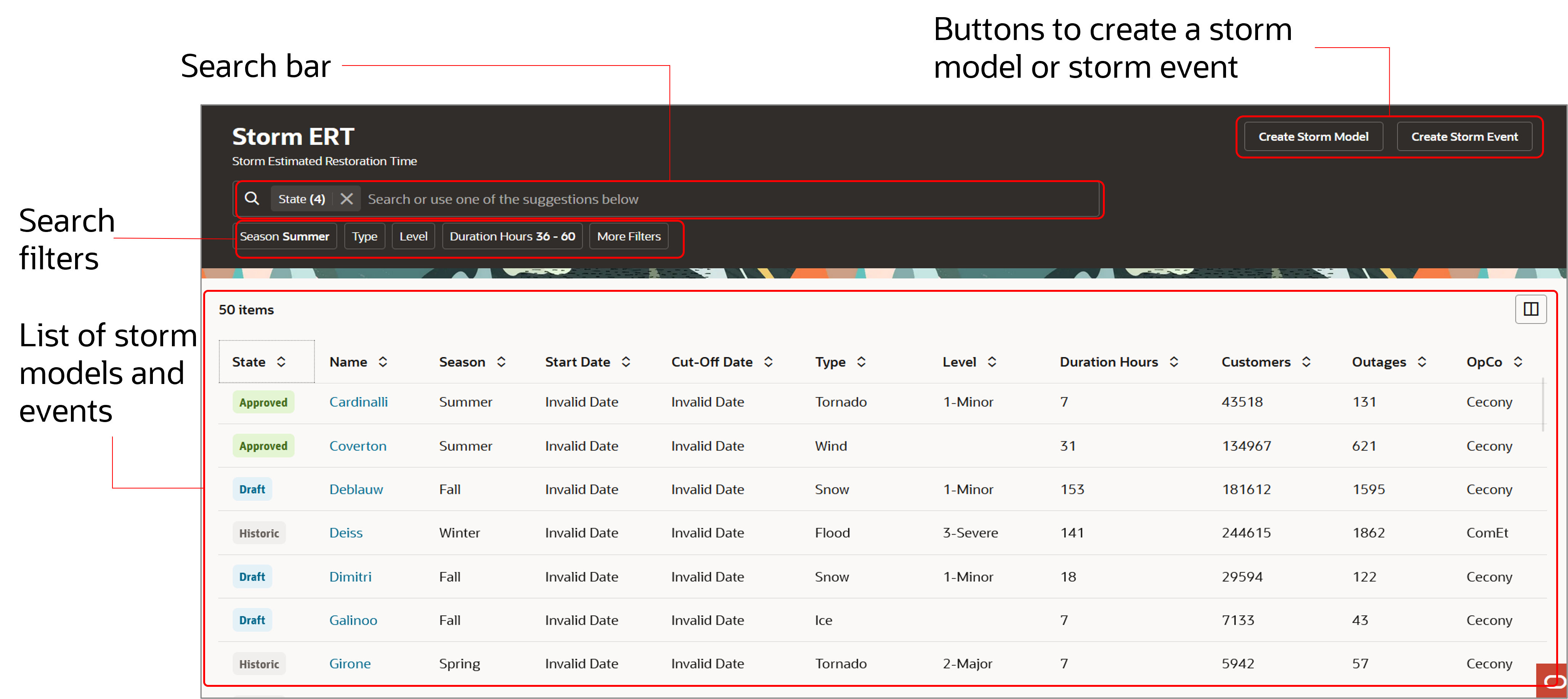

View the Storm ERT Dashboard
When you open the Storm ERT application, it displays a dashboard containing a search bar, search filters, buttons to create a storm model or event, and a list of storms you can click for more details. A storm is categorized as either a storm model or a storm event. A storm model allows you to estimate how long it will take to restore outages in an upcoming storm, whereas a storm event allows you to define the actual restoration timeline of a storm that occurred in the past so it can be used in future storm ERT calculations.

The search bar lets you use keywords to find a storm model or event. You can enter the name of a storm in the search bar if you already know what it is. You can also search for other key words to return a wider range of results. See Search for a Storm Model or Event.

Create Storm Model
A storm model defines when a storm will come and estimates how long it will take to restore power to customers who lose power as a result of the storm. After this information is defined, you can add an estimated restoration timeline (ERT) to the model, which displays a line graph for easy analysis. See Create and Manage Storm Models for more information.

Create Storm Event
A storm event defines the actual restoration timeline of a storm that occurred in the past, which can then be used in the ERT calculations of a storm model for an upcoming storm. Any storm in the Historic state is a storm event. After the storm event's parameters are defined (such as the start date and cut-off date), outage information from the Oracle Utilities Network Management System (NMS) or another connected outage management system is imported into the storm event based on those parameters. See Create and Manage Storm Events for more information.

Filters
A series of filters below the search bar allows you to narrow the list of storm models and events. Several default filters are displayed for quick selection. Click More Filters to select additional ones. Most of the filters are based on the columns in the list of storm models and events displayed under the search bar. See List of Storms Models and Events below for details.

List of Storm Models and Events
The dashboard includes a list of storms, each of which is displayed as a row in a table-like view. Each row includes columns about a storm, such as the state, name, start date, and so on. You can use a column picker to add or remove columns from the list, or to rearrange the order of columns. (You can use the same column picker button to restore the default column arrangement at any time.)
