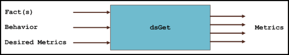

Datasets provide the criteria for the data to be used in an algorithm (such as, a Calc). When an algorithm is running, either manually or in a scenario, it pulls the data defined by a dataset from the population defined by a filter.
Note: Datasets use procedures called "get methods" to pull data from the population.

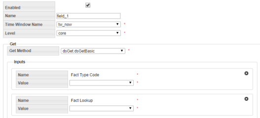

Dataset Fields
A dataset consists of one or more dataset field objects. Each dataset field object can be configured independently to access data from different time periods. Where time series data is queried, datasets allow dynamic aggregations to be done at runtime. The type of aggregation is decided by the method chosen and attached to the dataset field. Each dataset field generates metrics based on the type of method chosen.
Dataset Fields columns within a dataset record have the following basic characteristics:
- Enabled Flag: Allows fields to be disabled and their processing skipped. (Default: Enabled)
- Name: A user defined named for the field. Every reference to the dataset in a calc that it is bound to is done using the field name.
- Time Window Name: A reference to the time window configured in the time windows section that gets attached to a field. Each field has its own time window.
- Level: Each field is associated with a level, which is a point type code. Levels
allow a dataset to go up the relationship hierarchy and pull data from parent points and
make that available in the same dataset. Datasets require a level named
core, which must be set to the dataset's point type code. Additional levels may be added to get data from parent points. There is no limit on the number of levels, but performance may suffer if too many levels are added. - Get Method: A get method operates on the data for the time window attached to the field and aggregates it into several metrics.

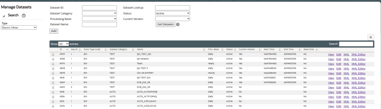

Manage Datasets Page
The Manage Datasets page provides fields and controls for filtering existing datasets and a data table that lists existing datasets. The Manage Datasets data table displays datasets based on the Type selected in the Search Pane.
Navigate to the Manage Datasets page by selecting Datasets from the Analytics section of the Manage menu. The datasets data table will load with the datasets that match the selected Type and Role or have no associated role.
Datasets Fields and Buttons
The top section of the Manage Datasets page allows you to search for datasets matching criteria added to the fields:
- Dataset ID: System generated dataset ID.
- Dataset Category: Assigned category for dataset.
- Processing Basis: Dataset processing basis is the type of data that the dataset is acting on (for example, Daily, Monthly, or Weekly data).
- Dataset Name: A dataset's "friendly" name.
- Dataset Lookup: Database lookup value. This is usually the dataset name without spaces in all caps.
- Status: Whether the dataset's status is set to Active or Inactive.
- Current Version: Whether the dataset is the current version in use.
- Get Datasets: Initiate the search for datasets matching the criteria set in the fields. Alternatively, you may press Enter when you finish adding content to a field and then click the Submit link when the system displays a message that the search criteria has changed.
- Add: Opens the Create Datasets dialog box from which you may create a new dataset.
Data Table
The data table contains information about the datasets. The table contains the following columns:
- ID: System generated dataset ID.
- Sequence ID: Dataset's sequence ID, which is its version number.
- Point Type Code: Code representing the object type (for example, EM for electric meter).
- Dataset Category: Category that a dataset is assigned to.
- Name: Dataset name.
- Start Time: Date/time when the dataset was set to current.
- End Time: End date for the dataset. For active datasets, the end time is set to an arbitrary end date used in the system; when a new version of the dataset becomes current, the end time is updated to equal the start time of the new version.
- Read Only: Whether the dataset is read-only or may be edited.
- View link: Opens the View Datasets dialog box, which displays the same data as provided in the data table row as well as buttons and links that allow you to edit or configure the dataset.
- Edit link: Opens the Manage Datasets dialog box, which displays an editable view of the dataset information.
- XML link: Displays the Dataset Definition dialog box, which shows the configuration XML for the dataset.
- XML Editor link: Opens the Datasets XML Editor.
- Expand button: Reveals the data in the data table for each table row as well as the following:
- Dataset Role: Setting for a role that is applicable to the dataset.
- Dataset Description: Optional setting that describes the dataset purpose.
- Lock Status: The dataset is locked to editing.
- Minimize button: Hide extra information for each data row.
Note: The data table may be exported by clicking the export data icon located above the table's search field.

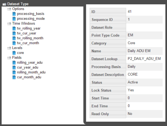

The View link in a dataset data table row launches the View Dataset dialog box, which displays the dataset information and allows you to view the dataset definition, edit the dataset information, create a new version of the dataset (clone), copy the dataset, or process the dataset.
Fields
- Dataset Role: Optional setting for a role that is applicable to the dataset.
- Point Type Code: Code representing the object type (e.g., EM for electric meter).
- Category: Assigned dataset category.
- Dataset Lookup: Database lookup value; usually the dataset name without spaces in all caps.
- Processing Basis: Dataset processing basis is the type of data that the dataset is acting on (e.g., Daily, Monthly, or Weekly data).
- Status: Dataset status (Active or Inactive).
- Lock Status: Whether the dataset is locked to editing.
- Start Time: Date and time when the dataset became active.
- End Time: End date for the dataset. For active datasets, the end time is set to an arbitrary end date used in the system; when a new version of the dataset becomes active, the end time is updated to equal the start time of the new version.
- Dataset Definition: Contains the XML link, which opens the Dataset Definition dialog box.

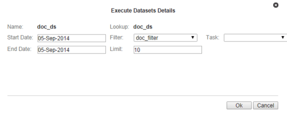

- Execute Now: Processes the dataset.

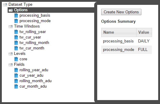

Add Options
When you select the Options heading in the tree-view, the editor will update with the Options Summary table, which lists existing options, and the Create New Options button.
Processing Basis
The processing_basis is automatically populated with the selections chosen when creating the dataset.
Processing Mode
Processing mode is pre-defined as FULL, which is the only option currently available in the XML Editor. It allows dataset processing to be time based such that given a time period, the dataset processing will take place for all time slices of the time period being run.

Add Fields
Fields allow you to select the type of fact to pull and how to pull it.
To add a field:
- Select Fields in the tree-view and click Create New Fields. If necessary, modify the name of the new field, then select the field to enable field criteria editing.
- Edit the field criteria:
- Name: The field name.
- Time Window Name: Drop-down list that allows you to reference one of the time window configured in Adding Time Windows. Each field has its own time window.
- Level: Drop-down list that allows you to reference a level configured in the Addling Levels section.
- Get Method: Drop-down list allows you to select a get method to operate on the data.
Get Methods
Each Get Method accepts a list of inputs and generates a list of output or metrics. Every data point in can be uniquely identified by a 4 member
tuple: point, fact, time, value.
In the context of a dataset, the point is provided by the filter attached to the
dataset, the fact comes from the list of inputs to the Get Method,
time is provided by the time window attached to the field and passed on to the Get
Method, and value is the raw fact value(s) that would be aggregated into a metric.
Metrics then are the outputs of a Get Method.
Your choice of Get Method depends on what type of fact you want to pull and will define how the fact will be aggregated in your dataset output.

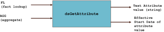

dsGetAttribute: Get attribute facts. Use the drop-down list to select the desired Fact Lookup. Aggregation mode is an additional field that allows you to select whether you want the first relation or the last relation found for that fact (if there happens to be more than one value within your selected time window).

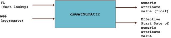

dsGetNumAttr: Get numeric attribute facts. Similar to dsGetAttribute; choose the fact lookup and aggregation mode, if applicable.

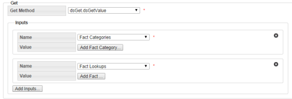

- dsGetValue: The dsGetValue is used to get a value with no aggregation. You can use dsGetValue to specify
a fact_category or a specific fact_lookup. However, regardless of the time window, this
will only return the first value of each fact (no aggregations).

| dsGetNumAttr | Numeric Attribute | Numeric attribute value (float) |

| dsGetAttribute | Attribute | Text attribute value (string) |

- Click View or Edit and then click Execute Now. The Execute Datasets Details dialog box will open:
- Select the process Start Date
and the process End Date, which are used as Data Start Date and
Data End Date in the time windows.
Note: You must select a filter to run your dataset on; the filter will decide which points for which to retrieve data.
Do one of the following:
- Click OK to process the dataset .
- Click Cancel to close the dialog box without processing the dataset.
