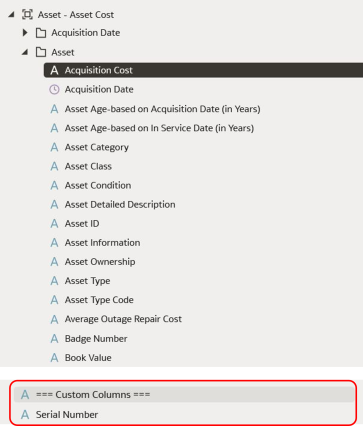

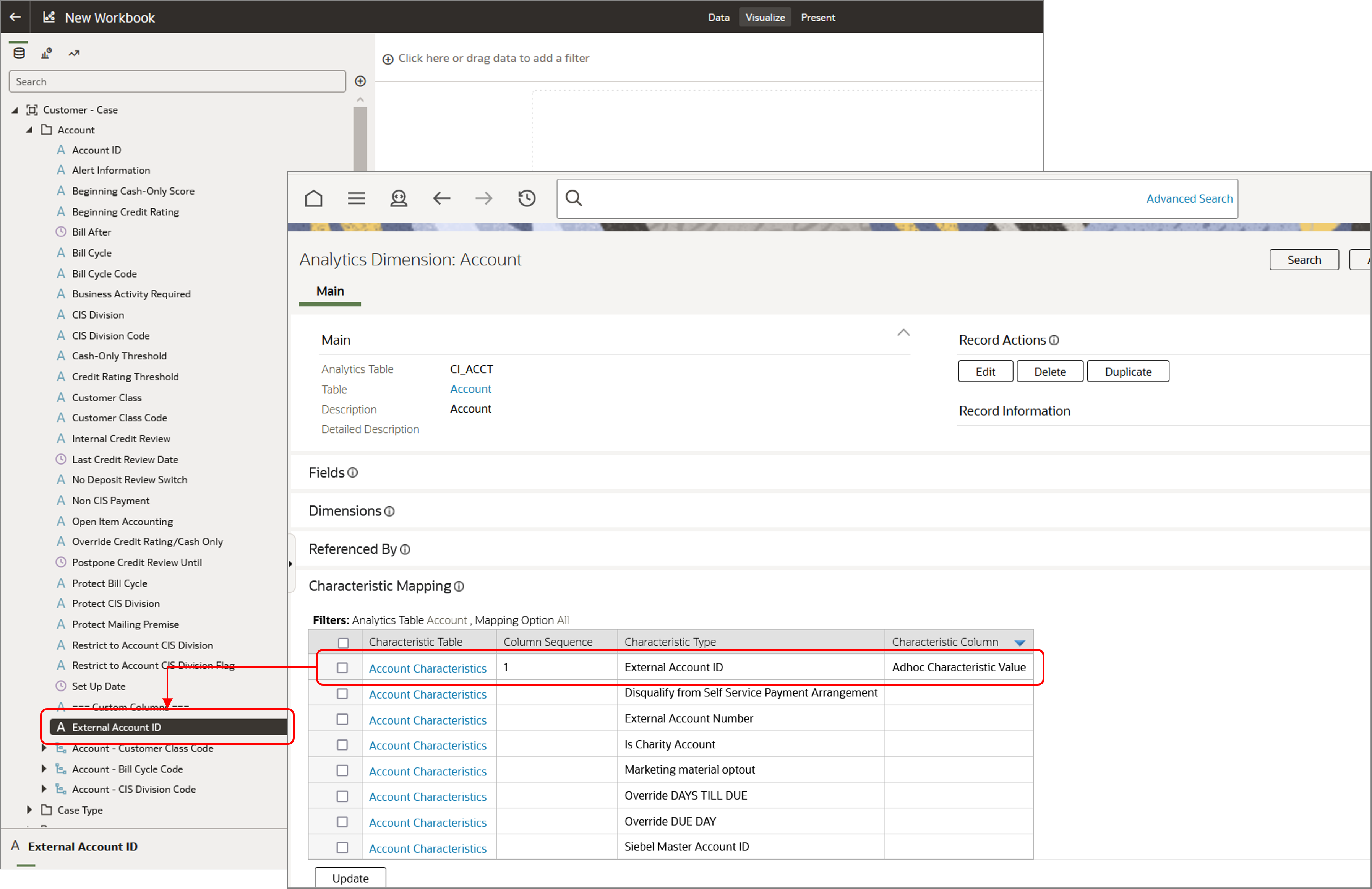

Custom values defined by characteristics types appear as columns with data type VARCHAR in dimension tables after they have been mapped to target dimensions in Analytics Visualization. For example, in the image below, the Account dimension includes the characteristic type External Account ID. Characteristics are displayed at the end of the dimension folder below the separator ==Custom Columns==.

The underlying maintenance object of each dimension supports a set of empty or free columns, which can be used by implementation teams to map characteristics. Each of these free columns has a unique identifier known as its Column Sequence. To map a characteristic to a target dimension in Analytics Visualization means to select a characteristic type of a table in the transactional application, and to map it to a free dimension column identified by its Column Sequence number.
The Column Sequence also determines the order in which characteristics are displayed in the dimension folder.

- In the Search Menu of your enterprise application (such as Customer Cloud Service, Meter Solution Cloud Service, or Work and Asset Cloud Service), enter "Analytics Table". The Analytics Table Search page displays.
- Search for the dimension. A set of results displays.
- Select the description link of the table where you want characteristics mapped. The description link takes you to the Analytic Dimension page shown in the screenshot above.
- Expand the Characteristic Mapping zone. This zone manages characteristic mapping extensions for the dimensions. By default, only mapped characteristics are listed.
- In the Characteristic Mapping zone, click the filter icon to search for a characteristic. To facilitate your search, you can use the options available to display all mapped and unmapped characteristics.
- Select one or more characteristic types that you want to map and click Update. This allows you to adjust your mappings for a selected list of characteristics.
Specify a value for the Column Sequence to create a mapping.
Note: Since Column Sequences are unique identifiers of dimension columns, the values that you specify must also be unique. It is best to start numbering your column sequence starting at 1 and increasing by 1.

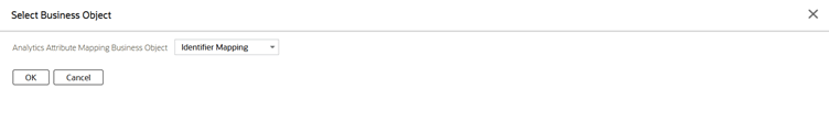

- Click the Add button. The Select Business Object screen displays.
- From the drop-down, select Identifier Mapping and click OK.
