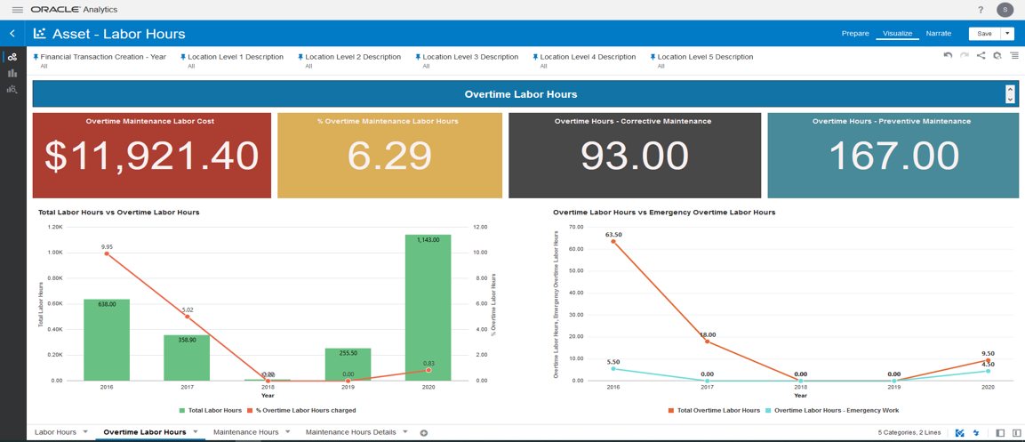

The Asset subject areas are based on data from the Oracle Utilities Work and Asset Cloud Service, such as activities, asset costs, and labor hours. The image below is an example of how data could look in the Labor Hours subject area.

Asset - Labor Hours
This subject area includes information related to labor hours against different charge types like activity, cost center, employee unavailability, or project in timesheet. You can get details about regular and overtime labor hours charged for different maintenance types.
Answer questions like these:
- What is the total labor cost, total labor hours, total regular labor hours, or total overtime labor hours distributed across departments or organizations?
 - What is the breakdown of labor hours by regular versus overtime?
 - What is the breakdown of labor hours by preventive maintenance versus corrective maintenance?
 - What are the top ten Asset Type, Activity Type, Resource Type consuming maximum labor hours?
 - What is the trend of total labor hours and overtime hours?
