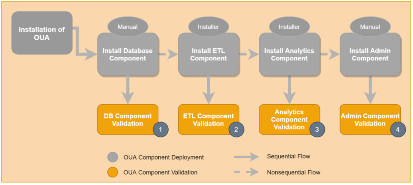

5 Installation of Oracle Utilities Analytics Warehouse
Using the instructions in the Oracle Utilities Analytics Warehouse Installation and Configuration Guide, install the Analytics Warehouse product. As part of the installation, the following components will be installed:
- Database component
- ETL component
- Analytics component
- Admin component
Installation of the database components must be completed first. Installation of the other three components are independent of each other, so they can be installed in any order. It is not necessary to install all components at once. You may choose to install one component at a time and then run their respective validations to ensure that the component is installed successfully before moving to the next component.
