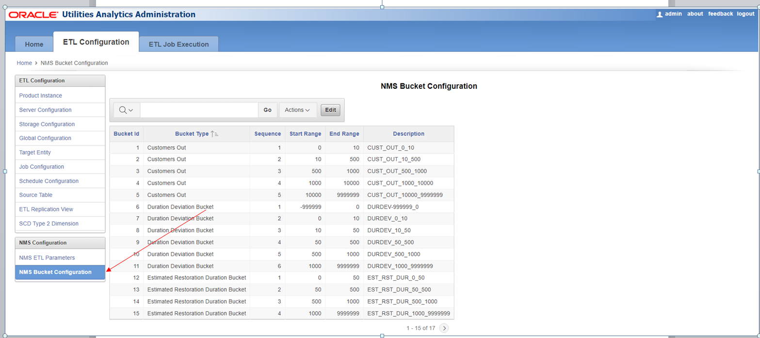

  1. Navigate to NMS Bucket Configuration under NMS Configuration (located on the Home tab of the Oracle Utilities Analytics Administration page).

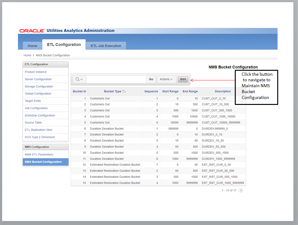

  2. Click Edit to open the Maintain NMS Bucket Configuration page.

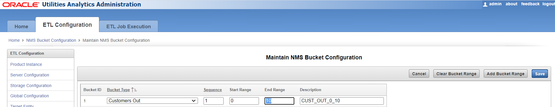

  3. Click Add Bucket Range and select the bucket type from the drop-down menu under Bucket Type column.
  4. Provide the Sequence, Start Range, End Range, and Description values.
    Note: The sequence number can start from 0. For single-valued buckets, this will hold a single value. However, for multi-valued buckets, the sequence number can be incremented for every additional value.
  5. Once the values are added, click Save.
