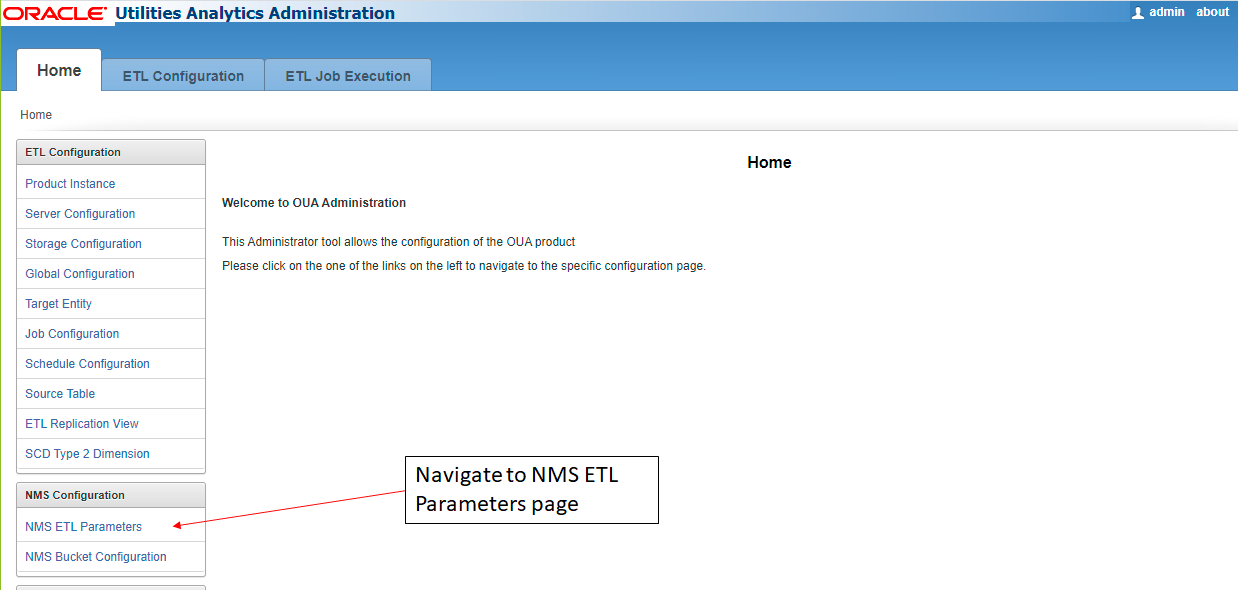

  1. Navigate to NMS ETL Parameters under NMS Configuration (located on the Home tab of the Oracle Utilities Analytics Administration tool).

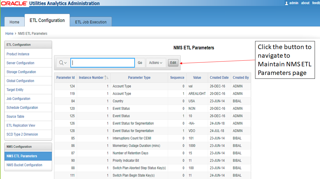

  2. Click Edit to open the Maintain NMS ETL Parameters page.

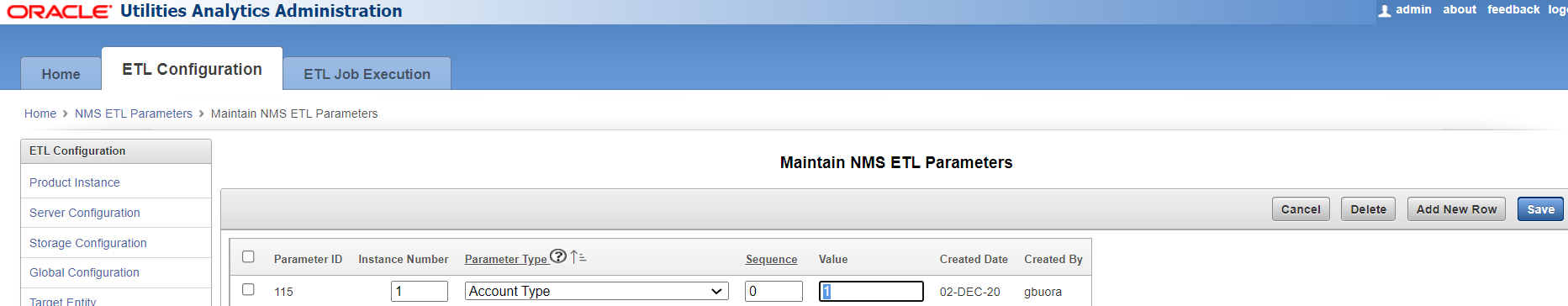

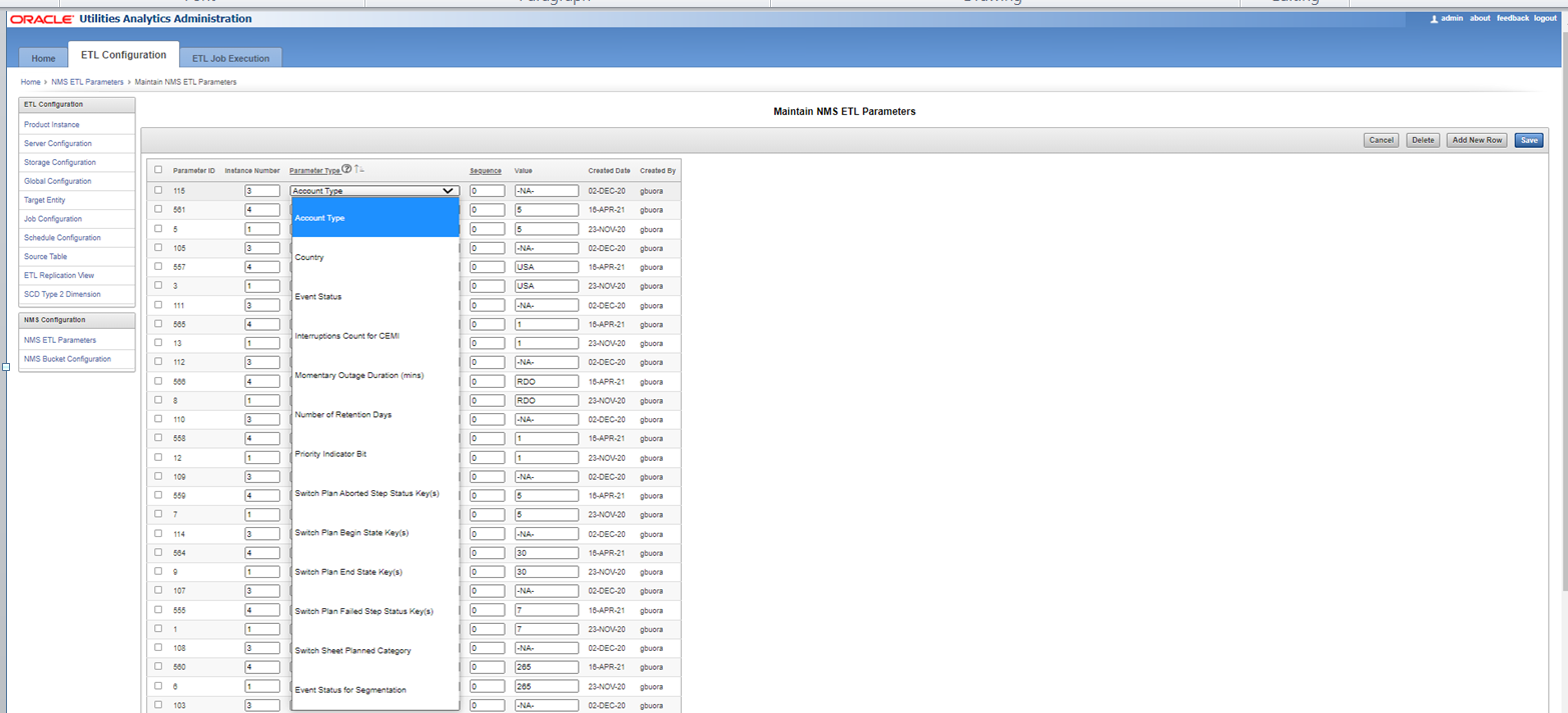

  3. Click Add New Row and select the parameter name from the drop-down menu under Parameter Type column.
  4. Provide the Instance Number, Sequence and Value. The sequence number can start from 0. For single-valued parameters, this will hold a single value. However, for multi-valued parameters, the sequence number can be incremented for every additional value.
    Screenshot of providing information in the Instance Number, Sequence, and Value fields.
  5. Once the values are added, click Save.
