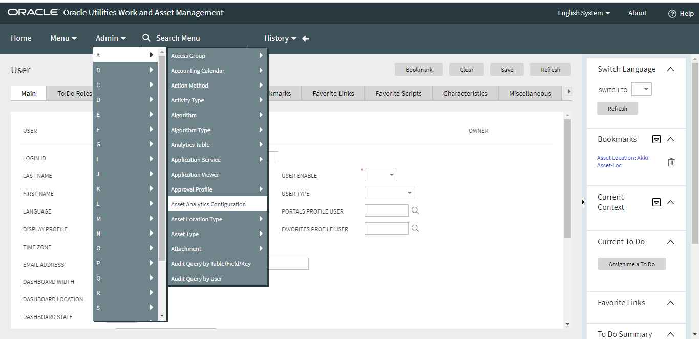

Asset Analytics Configuration Page
The Asset Analytics Configuration page holds information on all the analytics-oriented configuration tasks. It is a display-only portal that shows details about the configurations, providing links and guidelines to address further requirements to successfully run the ELT processes from OUAW.
To access the Asset Analytics Configuration page, log in to the source configuration and select Asset Analytics Configuration from Admin menu.
Screenshot of how to navigate to the Asset Analytics Configuration page.

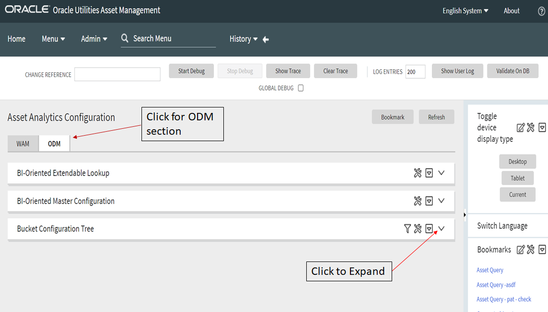

On the Asset Analytics Configuration page you will find WAM and ODM tabs. Click on the ODM tab to access the three main sections that will be described below: BI-Oriented Extendable Lookup, BI-Oriented Master Configuration, and Bucket Configuration Tree.
Screenshot of how to click the ODM section of the Asset Analytics Configuration page.

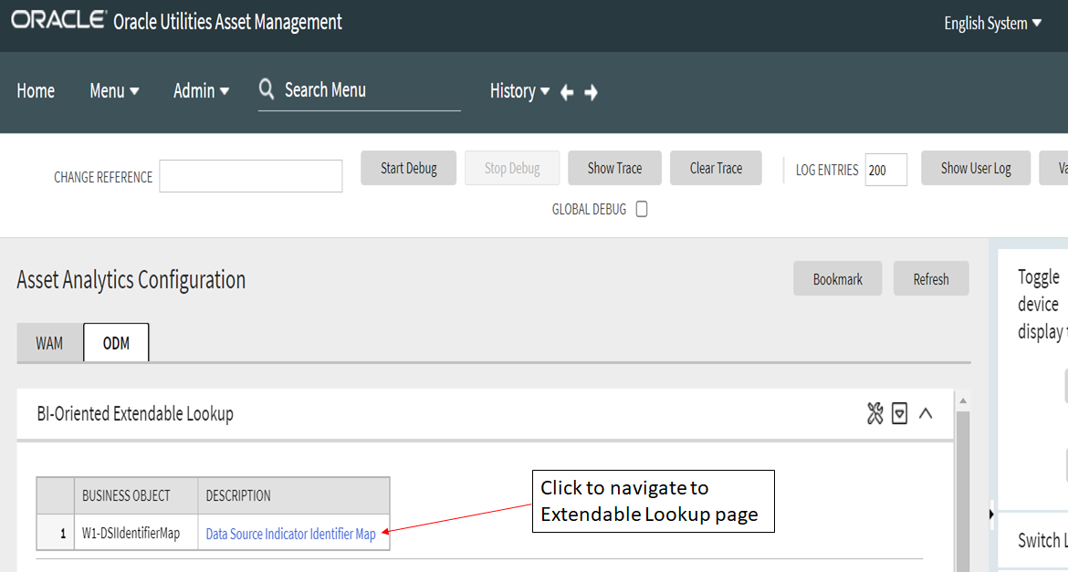

To navigate to the Extendable Lookup Maintenance portal where the lookup values are configured, click the link provided on the BI-Oriented Extendable Lookup zone.
Screenshot of how to navigate to the Extendable Lookup page.

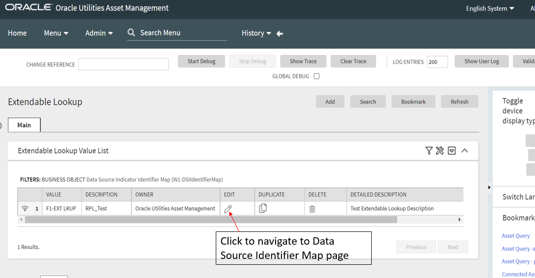

  1. Navigate to the Data Source Indicator Map page from the Extendable Lookup page as shown below.
    Screenshot of how to navigate to the Data Source Identifier Map page.

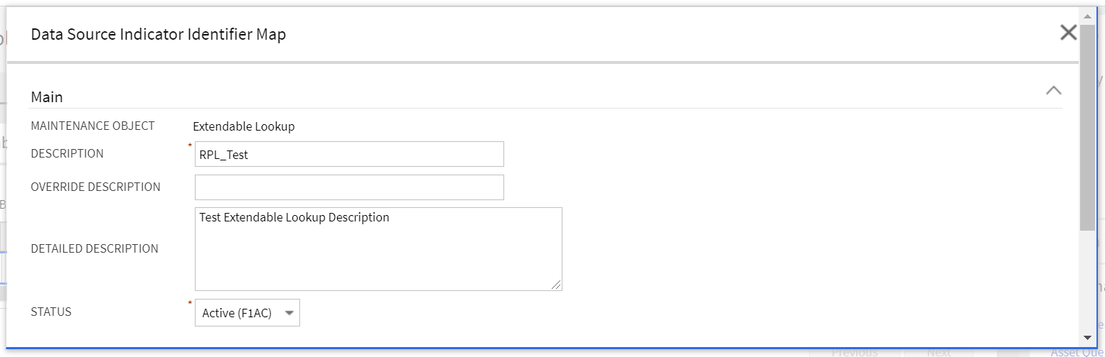

  2. Populate the fields under Main.
    Screenshot of how populate the fields in the "Main" subsection of the user interface.

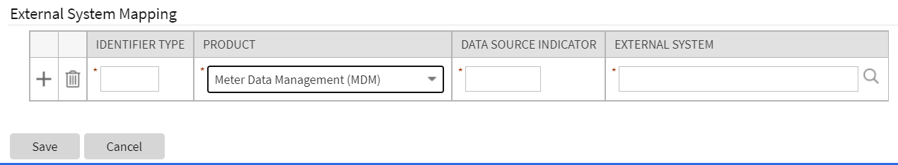

  3. Populate the fields under External System Mapping (the descriptions for these fields are provided on the table above). Click Save.
    Screenshot of how to populate the fields in the "External System Mapping" section of the user interface.

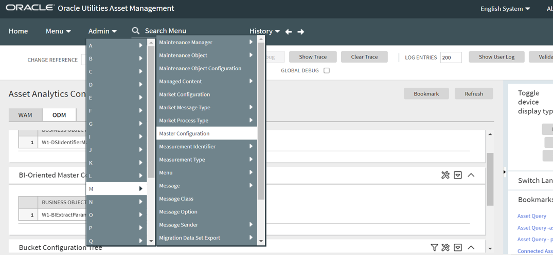

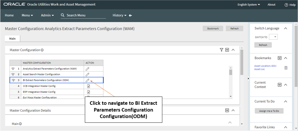

  1. Navigate to the Master Configuration page from the Admin menu.
    Screenshot of how to navigate to the Master Configuration page.
  2. Click Edit on the Action column for BI Extract Parameters Configuration (ODM) row.
    Screenshot of how to navigate to the BI Exotract Parameters Configuration.

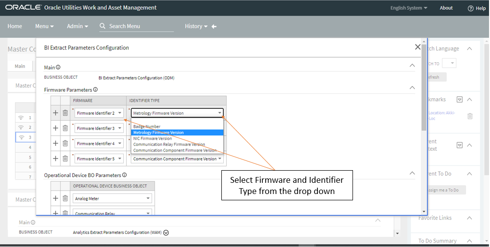

  3. On the BI Extract Parameters Configuration window, navigate to the Firmware Parameters section.
  4. Select the firmware and the identifier type from the drop-down menu and click Save. To add more values, click the Add (+) icon and populate the required fields.
    Screenshot of how to select the firmware and the identifier type from the drop-down menu.

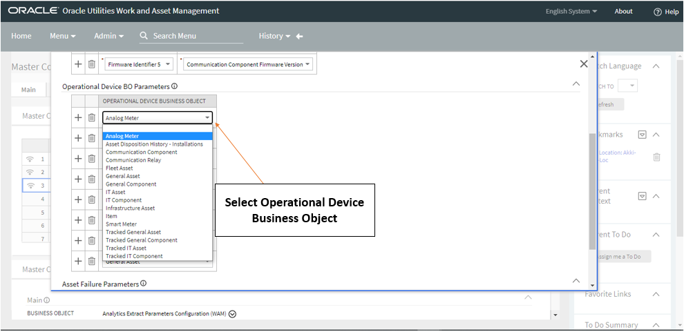

Operation Device BO Parameters
These parameters hold the business object names that are used to identify the operational devices that should be extracted. The Operational Device Snapshot and Operation Device Accumulation facts, as well as the Operational Device dimension in the Business Intelligence data warehouse, are designed to hold only the operational device data. Use this operational device parameter configuration to specify the business objects that are used to identify the assets that should be extracted into the star schema tables.
To set a value for this parameter:
  3. On the BI Extract Parameters Configuration window, navigate to the Operational Device BO Parameters section.
  4. Select the Operational Device Business Object from the drop-down menu and click Save. To add more values, click the Add (+) icon and populate the required fields.
    Screenshot of how to select the Operational Device Business Object from the drop-down menu.

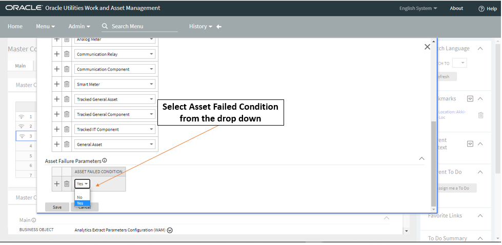

Asset Failure Parameters
These parameters hold the failure condition codes to be considered for identifying asset failures during the extraction process. The Operational Device Snapshot and Asset Location facts in the Business Intelligence data warehouse have specific columns that indicate an asset’s failure. Use this asset failure parameter configuration to specify the conditions that should be considered for marking an asset’s failure.
  3. On the BI Extract Parameters Configuration window, navigate to the Asset Failure Parameters section.
  4. Select the Asset Failed Condition from the drop-down menu and click Save. To add more values, click the Add (+) icon and populate the required fields.
    Screenshot of how to select Asset Failed Condition from the Asset Failure Parameters drop-down.

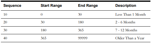

Asset Age Buckets

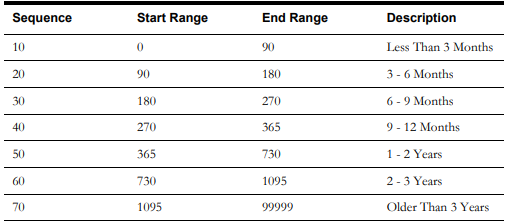

This configuration defines various bucket ranges that are used to classify how long an operational asset has been in the system. This bucket configuration data is extracted into the Asset Age Bucket dimension (CD_ASSET_AGE) and referenced in the Operational Device Snapshot fact to categorize an asset's age into the appropriate bucket.
No values are delivered as a part of the base product. Here are some sample values:
Default: Yes
Picture of a table showing sample values for the Asset Age Bucket configuration.
While selecting the Business Object in Select Bucket Configuration Business Object window, select the Asset Age Bucket Configuration (ODM) (W1-AssetAgeBuckets) option from the drop-down menu.
To add this bucket to the configuration list or reconfigure bucket ranges for configured buckets, see Configure ODM Buckets.

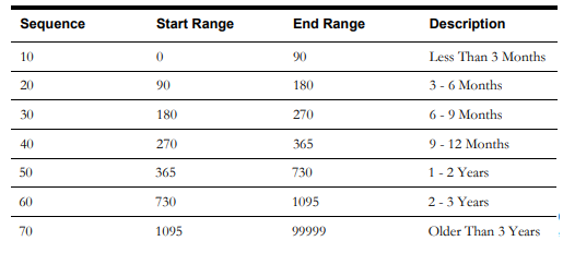

Asset Installation Age Buckets
This configuration defines various bucket ranges that are used to classify how long an operational asset has been installed on the field. This bucket configuration data is extracted into the Asset Installation Age Bucket dimension (CD_ASSET_INSTALL_AGE) and referenced in the Operational Device Snapshot fact to categorize an asset's install age into the appropriate bucket.
Default: Yes
Picture of a table showing sample values for the Asset Installation Age Bucket configuration.
While selecting the Business Object in Select Bucket Configuration Business Object window, select Asset Install Age Buckets (ODM) (W1-AssetInstallAgeBktConfig) option from the drop-down menu.
