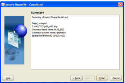

  9. Ensure the Create Predefined Theme box is unchecked, and click on Next.
  10. Review the summary information and click on Finish. A sample screenshot is shown below.
    Import Shapefile window displays a summary of the import files.

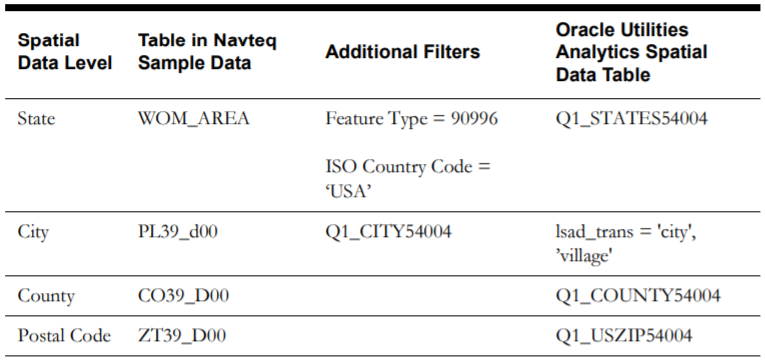

The following table provides a simple mapping based on the HERE maps sample data.
A table describing a simple mapping based on the HERE maps sample data.
Note: Apart from these four levels, there are also some standard themes and styles that need to be imported.

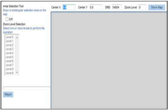

  3. Select the required online map tile and click on View Map/Manage Tiles. The Prefetching wizard opens.
    Wizard screen showing the Area Selection Tool and the Zoom Level Selection options on the left-hand pane, the coordinates bar on the top of the window, and a main area in the middle for the rendering of the map.
  4. Enter the X and Y coordinates of the center of the map, the SRID, and the zoom level. Click on Show Map.
    To prefetch map images, enter the latitude and longitude values. You need to know these values of the center of the location in interest. The SRID is a unique

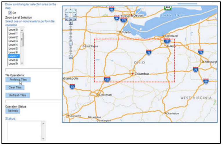

  5. When you see the map, turn on Area Selection and select the area on the map for which you want to prefetch the tiles.
  6. Select one or more zoom-levels for which you want to prefetch the tiles.

  5. Under Tile Operations, click on Prefetch Tiles. Here is a snapshot of the area selection and the tile operation.
    Example of a map displaying in the wizard.
This process takes some time, depending upon the hardware configuration of the system and the amount of data to be prefetched. To check the current status of the operation, click on Refresh under Operation Status. The status will change to Finished when the operation is done.
