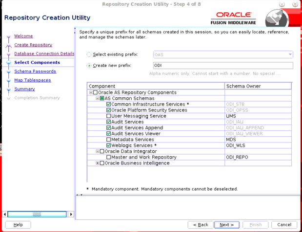

Configure repository |
Note: Keep track of the password given. It will be required while creating the Oracle Data Integrator domain. |
