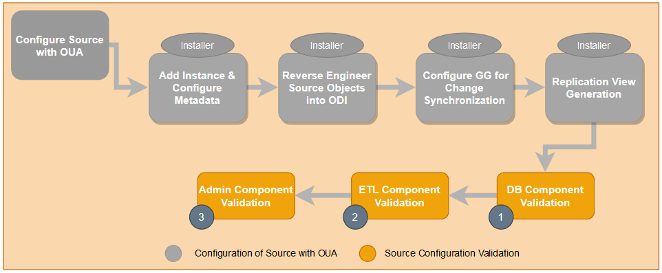

The Oracle Universal Installer must be used to configure a source. Follow the instructions provided in the Oracle Utilities Analytics Administration Guide to configure a source. The following image illustrates the high-level activities performed by the installer at the time of source configuration and all components that require validation. High-level tasks shown in gray will be performed by the installer at the time of source configuration.
