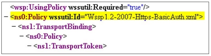

Example 1: The policy defined in the IWS wsdl is UsernameToken, meaning that oracle/wss_username_token_client_policy should be attached to the composite’s reference web service.Policy defined in the IWS wsdl
Example 2: The policy defined in the IWS wsdl is Https-BasicAuth xml meaning that HTTP Basic Authentication over SSL Including Timestamp is required. The oracle/wss_http_token_over_ssl_client_policy should be attached to the composite’s reference web service.
