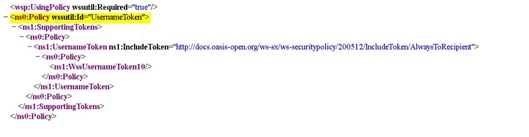

When calling an edge application Inbound Web Service, the security policy to attach to the reference web service of the composite is dependent on the annotation specified in the Inbound Web Service wsdl.
• If a security policy annotation is specified in the edge application’s Inbound Web Service, use the policy specified.
Example 1: The policy defined in the IWS wsdl is UsernameToken, meaning that oracle/wss_username_token_client_policy should be attached to the composite’s reference web service.
Example 2: The policy defined in the IWS wsdl is Https-BasicAuth xml meaning that HTTP Basic Authentication over SSL Including Timestamp is required. The oracle/wss_http_token_over_ssl_client_policy should be attached to the composite’s reference web service.
