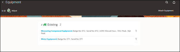

1. Navigate to the
Existing screen and click the equipment.

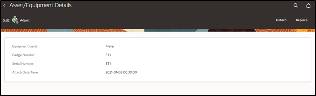

2. Click
Replace.

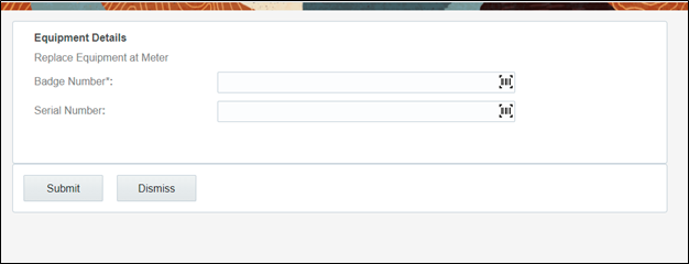

3. Enter the
Badge Number or the
Serial Number values to verify. Click
Submit.

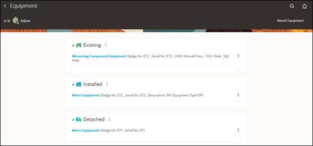

The existing equipment is added to the
Detached screen and the new equipment appears in the
Installed screen.
