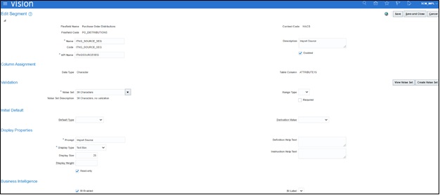

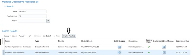

 Adding the DFF setup at PO Distribution Level:
1.	Navigate to Setup and Maintenance > Search > Manage Descriptive Flexfields.
2.	Search for the “Purchase Order Distributions” DFF.
3.	Edit it to add the following context and context sensitive segments.
	ITNG_SOURCE_SEG
4.	Deploy the modified flexfields.

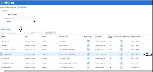

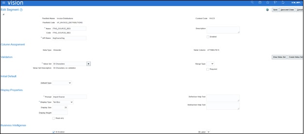

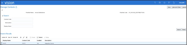

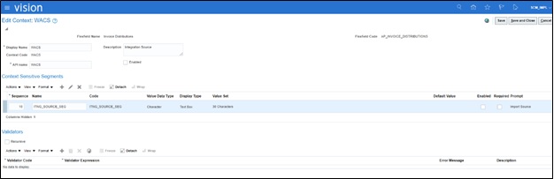

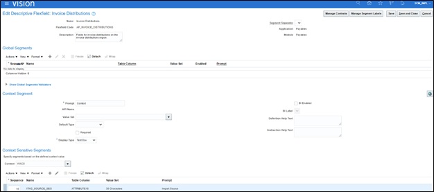

Setting up Invoice Distribution DFF
2.	Search for the “Invoice Distribution” DFF.
3.	Edit it to add the context sensitive segment.
Note: All attributes for distribution should have the same attribute for it to flow from Purchase Requisition to Purchase Order and Invoice.
 To access the Manage Invoice Options task:
1.	Navigate to Setup and Maintenance > Define General Payables Options > Manage Invoice Options.
2.	Make sure that the business unit context is set.
3.	Drill down to Manage Invoice Options and open the task.
4.	Make sure the
Transfer PO Distribution Additional Information setup is complete to copy the PO distribution DFF values. See the following figure.
 5.	Click Save and Close.
