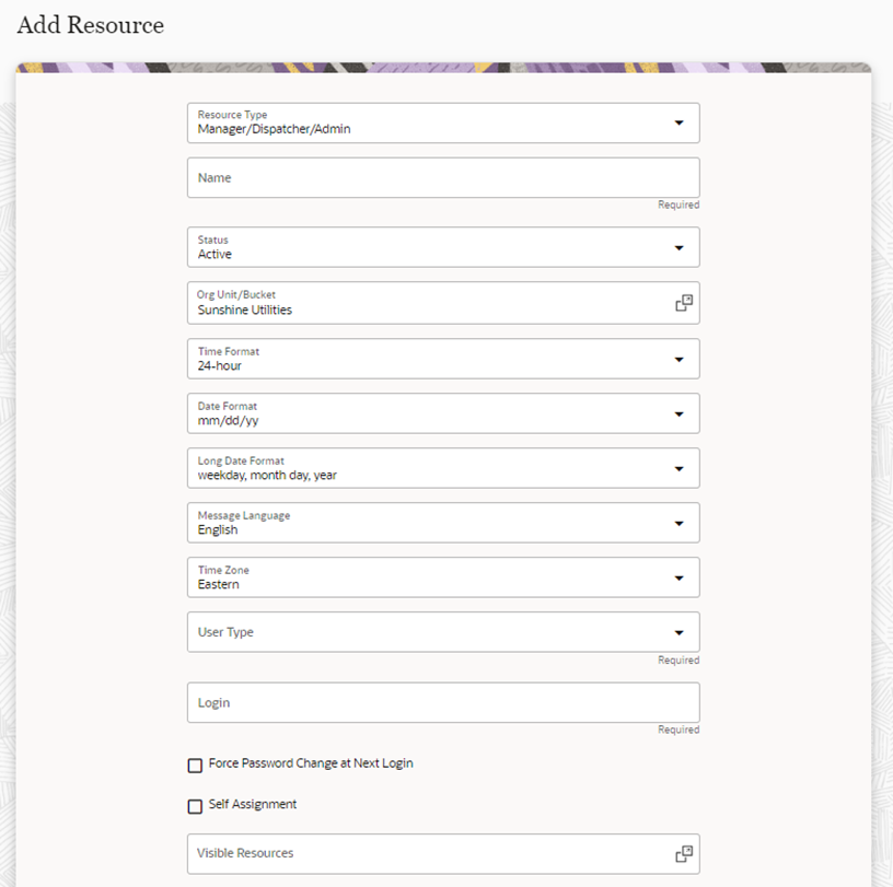

To configure resource and bucket information:
1. On the Oracle Field Service Home page, click the three lines on the top-left corner.
2. Click Resources and search for respective bucket.
3. Click Add Child Resource.
4. Select Bucket to add a new bucket in the Resource type.
5. Enter the required details and click OK.

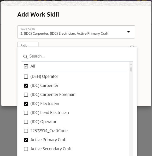

6. Click Add child resource and select Technician from the Resource type drop-down list. Click OK.Resource information page detail. The options menu is located on the upper right corner.
7. Select the required work skills to this Technician. Click Save.Resource Work Skills page.
