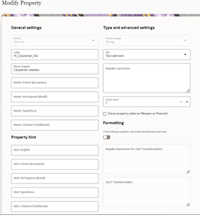

2. A work skill property on the activity level is created in Oracle Field Service for each craft synced from Oracle Utilities Work and Asset Cloud Service. This property will contain information about how many people with the particular work skill is needed for the activity. The label format for Work Skill property created in Oracle Field Service is:
W_ + WAM craftcode + _Nd
Example: Work skill property created in Oracle Field ServiceModify Property section where the user is to provide the new name and label to modify the work skill property.

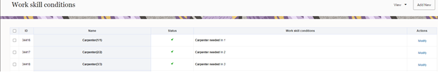

3. Work skill conditions are created in Oracle Field Service based on the craft and the configuration property value of workSkillCond.actvtySameSkillMaxWorker.default obtained from WAMOFSC_ConfigProps lookup defined in Oracle Integration Cloud. This configuration property value contains the maximum number of people with the same work skill allowed to work simultaneously in an activity.
In this example: For work skill = Carpenter and workSkillCond.actvtySameSkillMaxWorker.default = 3, these are the work skill conditions created.
Example: Work skill conditions created for Work Skill Carpenter in Oracle Field ServiceWork Skill Conditions page showing the work skill conditions in a table that presents their ID, Name, Status, and possible Actions.
These configurations are used to track teams (crews) consisting of people with different work skills and make sure that activities that require several people simultaneously is assigned to the right team.

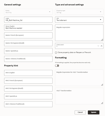

5. A work skill property on the activity level is created in Oracle Field Service for each equipment synced from Oracle Utilities Work and Asset Cloud Service. This property will contain information about how many people with the particular work skill is needed for the activity. The label format for work skill property created in Oracle Field Service is:
WE_ + WAM equipmentcode + _Nd
Example: Work Skill Property created in Oracle Field Service
