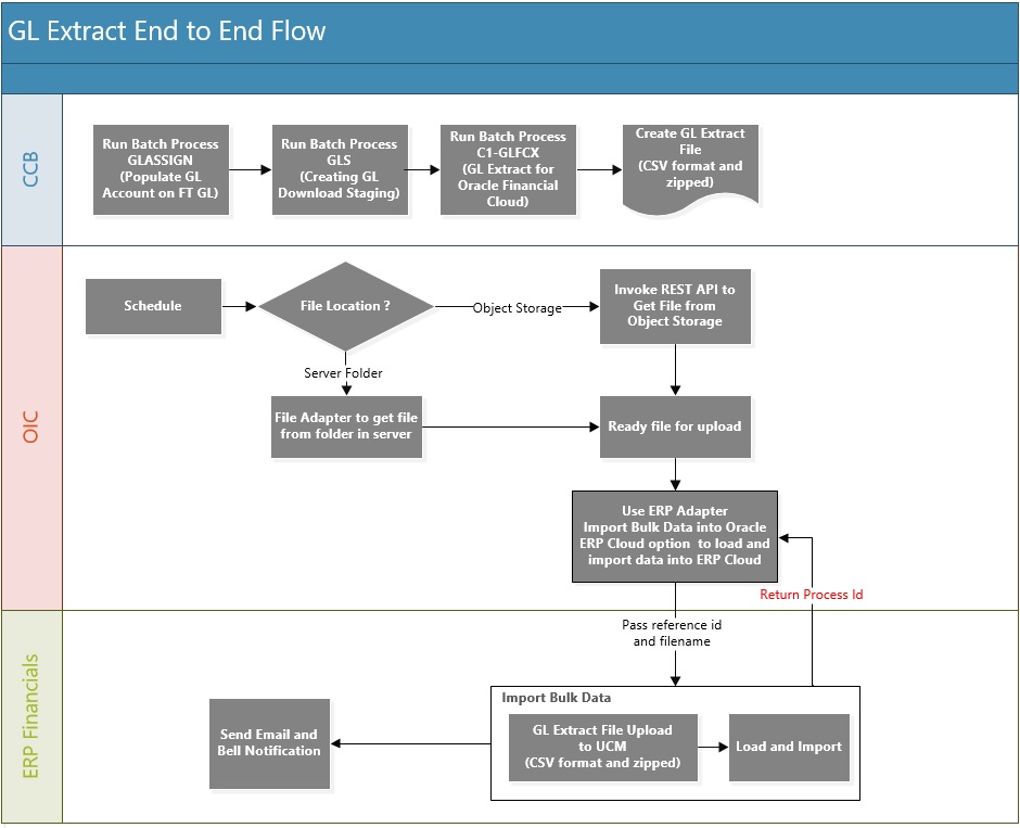

General Ledger Integration
The objective of General Ledger interface is to integrate the General Ledger transactions originating in Oracle Utilities Customer Cloud Service/Oracle Utilities Customer Care and Billing with Oracle Financial Cloud - General Ledger. As Oracle Utilities Customer Cloud Service/Oracle Utilities Customer Care and Billing users take actions within the application that necessitates sending the accounting entries to Oracle ERP Financial, this interface extracts the General Ledger transaction data from Oracle Utilities Customer Cloud Service/Oracle Utilities Customer Care and Billing, translate it and move it to cloud as Journal voucher transactions in the General Ledger.
This integration includes:
• Oracle Utilities Customer Cloud Service/Oracle Utilities Customer Care and Billing Initiated: Batch process “GLASSIGN” is mandatory to run for this integration that helps to populate GL account of the financial transaction of General Ledger.
• Batch “GLS” is processed after assigning the General Ledger account that moves the appropriate General Ledger transactions to staging table in Oracle Utilities Customer Cloud Service/Oracle Utilities Customer Care and Billing.
• Batch process “C1-GLFCX” in Oracle Utilities Customer Cloud Service extracts all General Ledger transaction and load the zip file to Object storage.
• Batch process “C1-GLFCX” in Oracle Utilities Customer Care and Billing extracts all General Ledger transactions and loads the zip file to file path location for on premises.
• ERP Flow: Batch process “Load to Interface” to pick up the transaction data from the UCM interface, insert the information into an ERP interface table and invoke a journal import data into ERP Financial Cloud application.
• Financial interface procedure(s) to pick up transaction information from the interface table and import the data into Financial General Ledger.
• The data imported into ERP Financial will be posted by submitting the Posting Journal Program as per the business process.
• Verification of data can be done in ERP before making the posting.
• All the transaction are based on the existing code combinations interfaced by ERP system. Any correction or changes in the transaction would be new transaction to adjust the values (if needed).

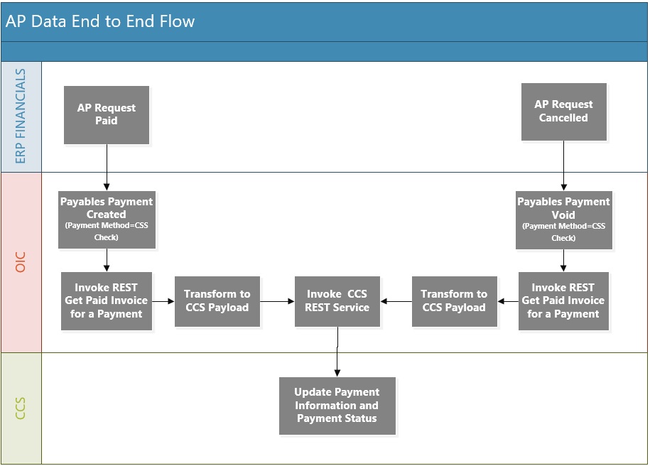

Single Payment/Void Payment Process
• For the refund request invoice created, the payment details are sent from Oracle ERP Financial Account Payable to Oracle Utilities Customer Cloud Service/Oracle Utilities Customer Care and Billing.
• Payables sends an event occurrence signal when the event has happened using a user interface or by a REST API.
• Gets the details of paid invoice through REST API and transforms into Oracle Utilities Customer Cloud Service load.
• Updates payment information and payment status for the adjustment in Oracle Utilities Customer Cloud Service.
• Passes the payment or void information and payment status for the account payment request from Oracle ERP Financial Cloud to Oracle Utilities Customer Cloud Service.
• For configuration to be performed in Oracle Utilities Customer Cloud Service and Oracle ERP Financial Cloud for the integration are listed in Configuring Oracle Utilities Customer Cloud Service and Configuring Oracle ERP Product Hub Cloud respectively.
• Integration updates the following payment information for each Adjustment AP Request record using a business event:
• A/P Request ID (Primary Key)
• Payment Status
• Payment Date
• Payment Method and Number
• Payment Amount and Currency

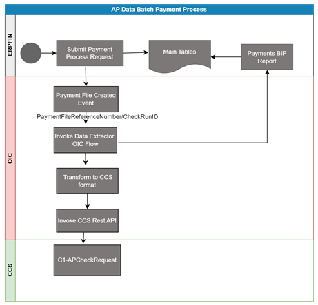

Batch Payment Process
• For the refund request invoices created, payment details are sent from Oracle ERP Financial Account Payable to Oracle Utilities Customer Cloud Service/ Oracle Utilities Customer Care and Billing.
• Payables sends the Payment File Created event when a Submit Payment Process Request is created in Oracle ERP Financial Cloud.
• Gets the details of all paid invoices through a BI Report using the Payment File Reference Number that is extracted from the event data.
• For each invoice:
• Transforms into Oracle Utilities Customer Cloud Service load.
• Updates the payment information and payment status for adjustment in Oracle Utilities Customer Cloud Service.
• For instructions to configure Oracle Utilities Customer Cloud Service and Oracle ERP Financial Cloud in the integration, refer to the Configuring Oracle Utilities Customer Cloud Service and Configuring Oracle ERP Product Hub Cloud chapters.
• The integration updates the following payment information for each Adjustment AP Request record using a business event:
• Payment Status
• Payment Date
