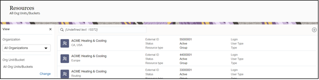

2. Click Resources and search for respective bucket.Resources All Org Units Buckets page.
3. Click Add Child Resource.

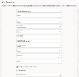

4. Select Bucket to add a new bucket in the Resource type.
5. Enter the required details and click OK.

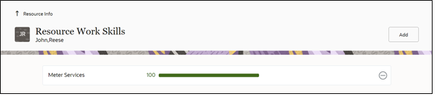

6. Click Add child resource and select Technician from the Resource type drop-down list. Click OK.Resource Work Skills page.
7. Select the required work skills to this technician. Click Save.Resource Work Skills page.
