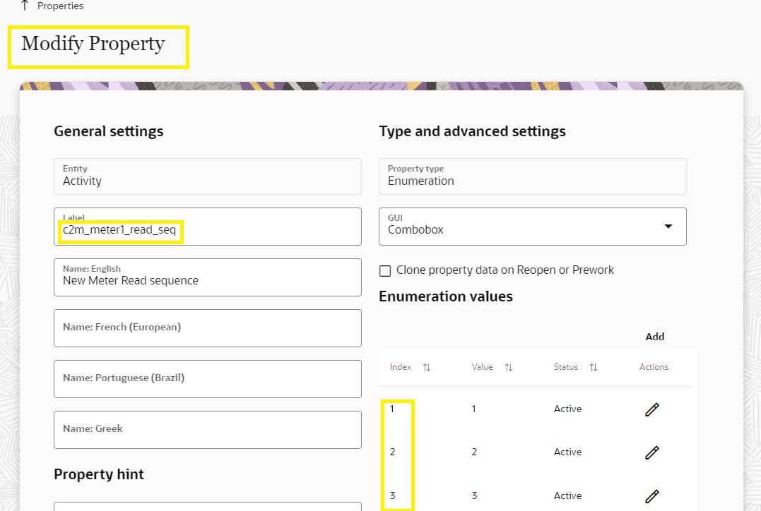

7. To provide the value for “c2m_new_meter_type”, open the property and identify the default meter type to be used in the offline mode and use the respective Index value in the above condition.
8. To provide the default value for “c2m_meter1_read_seq”, open the property and view the index.
Example: “1” in the above condition represent the Index value in the “c2m_meter1_read_seq” enumeration property.Modify Property window.

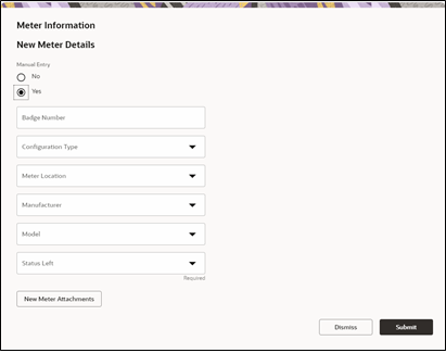

3. Select Meter Details to enter the information.

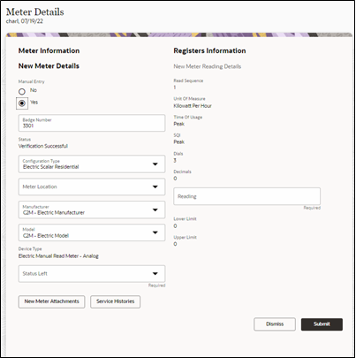

If the device is offline, crew should select Manual Entry as Yes and select the configuration type.Meter Details page detail. On this image the Manual Entry appears as set, and the Configuration Type is set as Default One Register Electric meter.
4. After the respective fields are selected based on pre-configuration the registers information is displayed as below. Click Submit. Meter Details, information page.

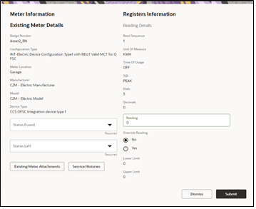

3. Select Meter Details and navigate to the user interface.Meter Details page.
The lower and upper limit are part of message from Oracle Utilities Customer Cloud Service. It infers that reading should be ideally between these limits but a crew can always override the recommendations. If the reading is not between these limits the application displays an error.Meter Details page showing the reading limit error.
