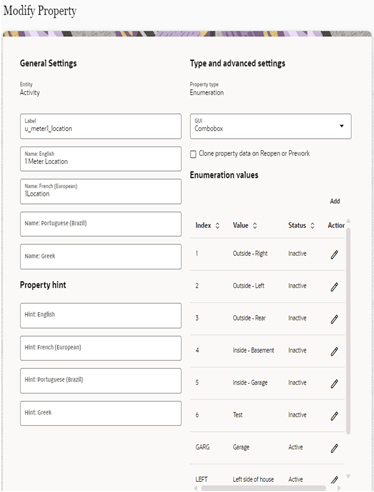

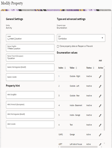

To add values to the enum property:
1. Log in to Oracle Field Service.
2. Navigate to Configuration > Resource, Activities, Inventories > Properties.
3. Search for the property with label.
4. Click Modify Property.
Values field shows a combination of Description[id]. Example: Simple Electrical[E-DEFAULT]Modify property window.
5. In the English field, enter the description and code.
6. Enter "Item" to verify an item as part of custom activity and activity as part of ID. Example: Item[Custom_item_activity_type]
7. Click Add to add the values to the Values list.
8. Click Update to save the value to the property.

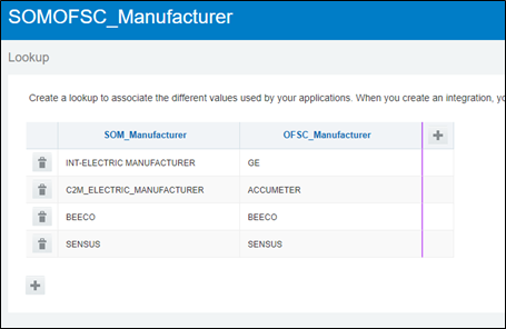

9. Add entry to the corresponding Oracle Integration Cloud look up.
Example: After adding value to the Manufacturer properties, add an entry to the SOMOFSC_Manufacturer Oracle Integration Cloud lookup.
To add an entry to the lookup:
1. Login to Oracle Integration Cloud.
2. Navigate to Designer > Lookups.
3. Search for the respective lookup.
Example: SOMOFSC_ManufacturerLookup details.
4. Click +.
5. Enter the SOM code in the SOM_Manufacturer column.
6. Enter the ofsc enum field ID in the OFSC_Manufacturer column.
7. Click Save.
8. Deactivate and activate the integration using the lookup.
