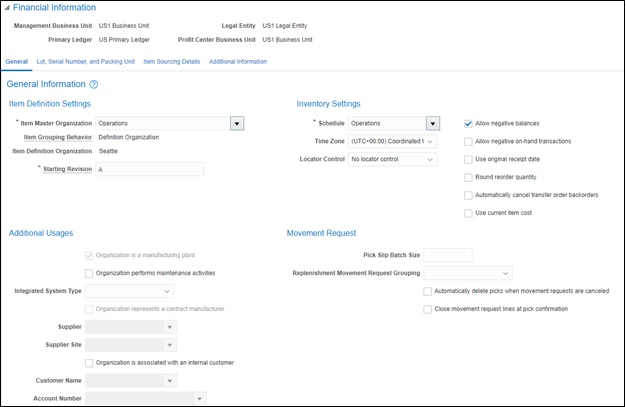

Setting up Inventory Organization and Location (Delivery Location)
This section describes a sample setup for reference. The setup will depend on the customer/business implementing the integration.
Inventory Organization Name: Seattle
Organization Code: 001

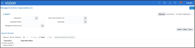

Navigate to Setup and Maintenance > Search > Manage Inventory Organization. Search for the organization.

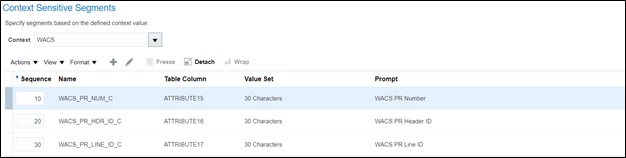

2. Click PO_REQUISTION_LINES and edit it.
3. Click Manage Context and add contexts with all the context sensitive segments.
4. Click the edit icon to add segments.

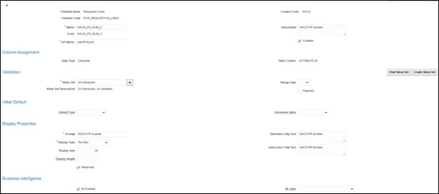

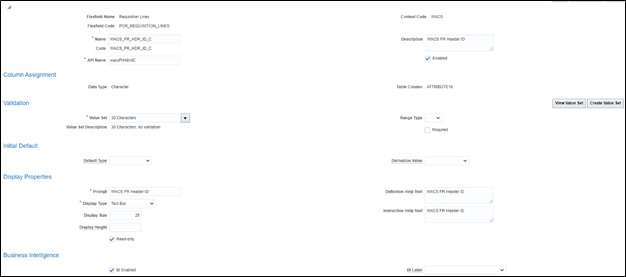

5. Add the following context sensitive segments and the respective details for each segment.
WACS_PR_NUM_C
WACS_PR_HDR_ID_C
WACS_PR_LINE_ID_C
Make sure the API names (example: wacsPrNumC ) of the respective column name should be shown in the figures above. API names are referred in the REST API integration. Any mismatch in the names might lead to an error in the integration.

POR_REQUISITION_LINES DFF Setup Details
Column Name
Data type
Size
Table column
Prompt
WACS_PR_NUM_C
Character
V.S: 30 Characters
30
ATTRIBUTE15
WACS PR Number
WACS_PR_HDR_ID_C
Character
V.S: 30 Characters
30
ATTRIBUTE16
WACS PR Header ID
WACS_PR_LINE_ID_C
Character
V.S: 30 Characters
30
ATTRIBUTE17
WACS PR Line ID

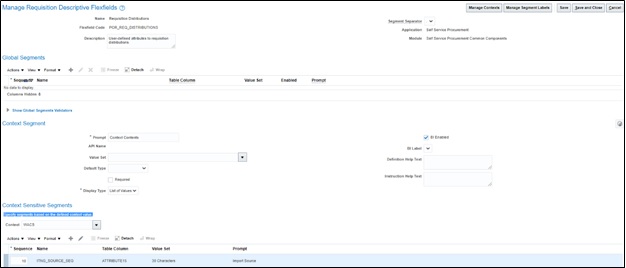

To setup descriptive flexfields at the requisition distribution level:
1. Navigate to Setup and Maintenance > Search > Manage Requisition Descriptive Flexfields.
2. Click POR_REQ_DISTRIBUTIONS and edit.
3. Click Manage Context to add the respective context.
4. Add context sensitive segments to the context.

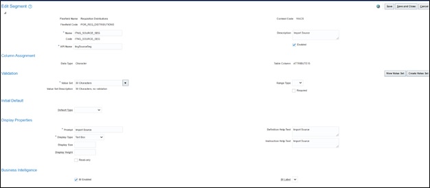

The following figure shows the “ITNG_SOURCE_SEG” segment details.
5. Click Save and Close.
Note that both requisition line and distribution (deploy flexfield) should be complied. Make sure that the deploy status is enabled.
