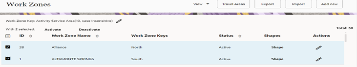

1. Navigate to Configuration > General > Work Zones.
2. Make sure the Work Zone Key displayed (top left corner) is “Activity Service Area”.Configuration, Work Zones page showing the ZIP Postal Code Work Zone Key on the top left corner.

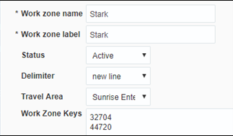

3. On the Work Zone page, click Add new to add the required service area in the Work Zone Keys field.Add new window where the user is to add the work zone name and label, set an status, a delimiter, a travel area, and finally add the postal codes on the Work Zone Keys text field.
4. Click Add to save the new work zone.
