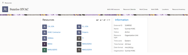

1. On the Oracle Field Service Home page, click the icon showing three horizontal linesv(on the top-left corner).Oracle Field Service Home page detail showing the three lines menu located on the top-left corner.
2. Click Resources and select the resource to view its information.
3. Click Add child resource.Resource Info page showing the resource’s name on the top left side, and the four lines menu on the top right.

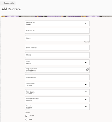

4. Select Bucket to add a new bucket in the Resource type drop-down list.Add Resource window where the user is to choose from the drop-down menus and fill the different text fields with the resource’s details.
5. Enter the required details and click Submit.
