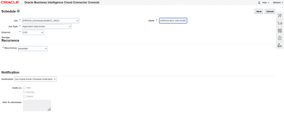

1. From the toolbar on the right pane, click Manage Jobs > Manage Job Schedules.
2. Click Add.
3. Enter the Job Name, External Storage, Job Type, and Job Name. Click Save.
Note: The status should be “Succeeded”.
