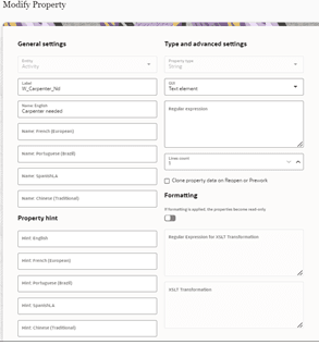

2. A work skill property on the activity level is created in Oracle Field Service for each craft synced from Oracle Utilities Work and Asset Cloud Service. This property will contain information about how many people with the particular work skill is needed for the activity. The label format for Work Skill property created in Oracle Field Service is:
W_ + WAM craftcode + _Nd
Example: Work skill property created in Oracle Field ServiceModify Property section where the user is to provide the new name and label to modify the work skill property.

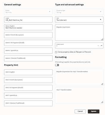

5. A work skill property on the activity level is created in Oracle Field Service for each equipment synced from Oracle Utilities Work and Asset Cloud Service. This property will contain information about how many people with the particular work skill is needed for the activity. The label format for work skill property created in Oracle Field Service is:
WE_ + WAM equipmentcode + _Nd
Example: Work Skill Property created in Oracle Field Service.
