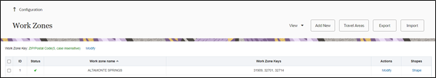

To configure a work zone:
1. Navigate to Configuration > General > Work Zone.
2. Make sure the Work Zone Key (top-left corner) is ZIP/Postal Code. Work Zones page detail.
3. On the Work Zones page, click Add new to add the required postal codes in the Work Zone Keys field.Add new page where the user is to populate text fields.
4. Click Add to save the new work zone.
